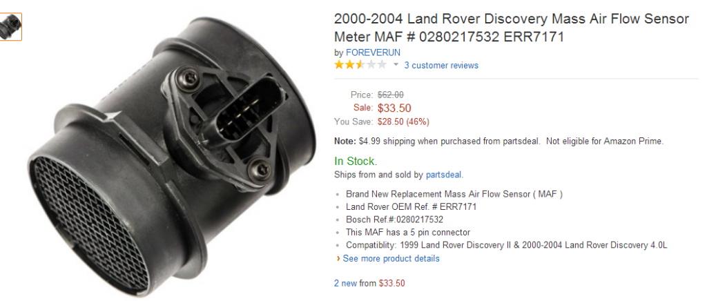

I need to get a couple of MAFs for a 00 and a 02 Disco II. I haven't bought one in a awhile, and want to make sure I get the right one at the right price.

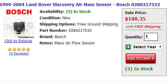

First, BPUTAH is a great place to buy everything, and they have them as follows:
Partsgeek is alot cheaper.
And since I have to buy two, that is a 90 dollar savings plus shipping.
Then I hit up Amazon and BANG.
The comments to the Amazon offering say that the barrel doesn't fit 2003-2004. So I searched the forums here and found a comment that the operative part (that slides in the barrel, kept in place by the security screws) is the same for both the 99-02 and 03-04 models, but that the barrel diameter is less for the latter. I further found out that a VW part (also Bosch) may be exactly the same part I need.
I only need to replace the innards. What should I buy? If it is just the part that slides in the barrel, then maybe I can find that locally. Any guidance?

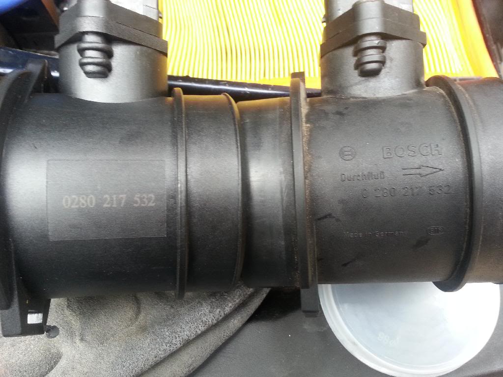

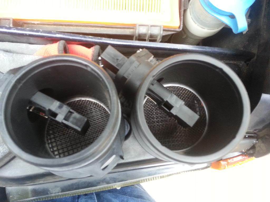

Got mine yesterday. I'll post pictures and report install results as soon as I get my overalls on. It is raining of course.
UPDATE:
The MAF fits and works on my 2000 Disco II
Update II:
A look inside the new one (left) and old, stock, one (right).
New on left, old on right.
It fits. No issues.
Ran the truck for a bit. No codes. Drove it. No problems.
To my list of amazing finds (30 dollar A/C compressor and 20 dollar Power steering pump, both of which have worked for a year and are still strong), I think this 33.50 Amazon MAF must be added.
