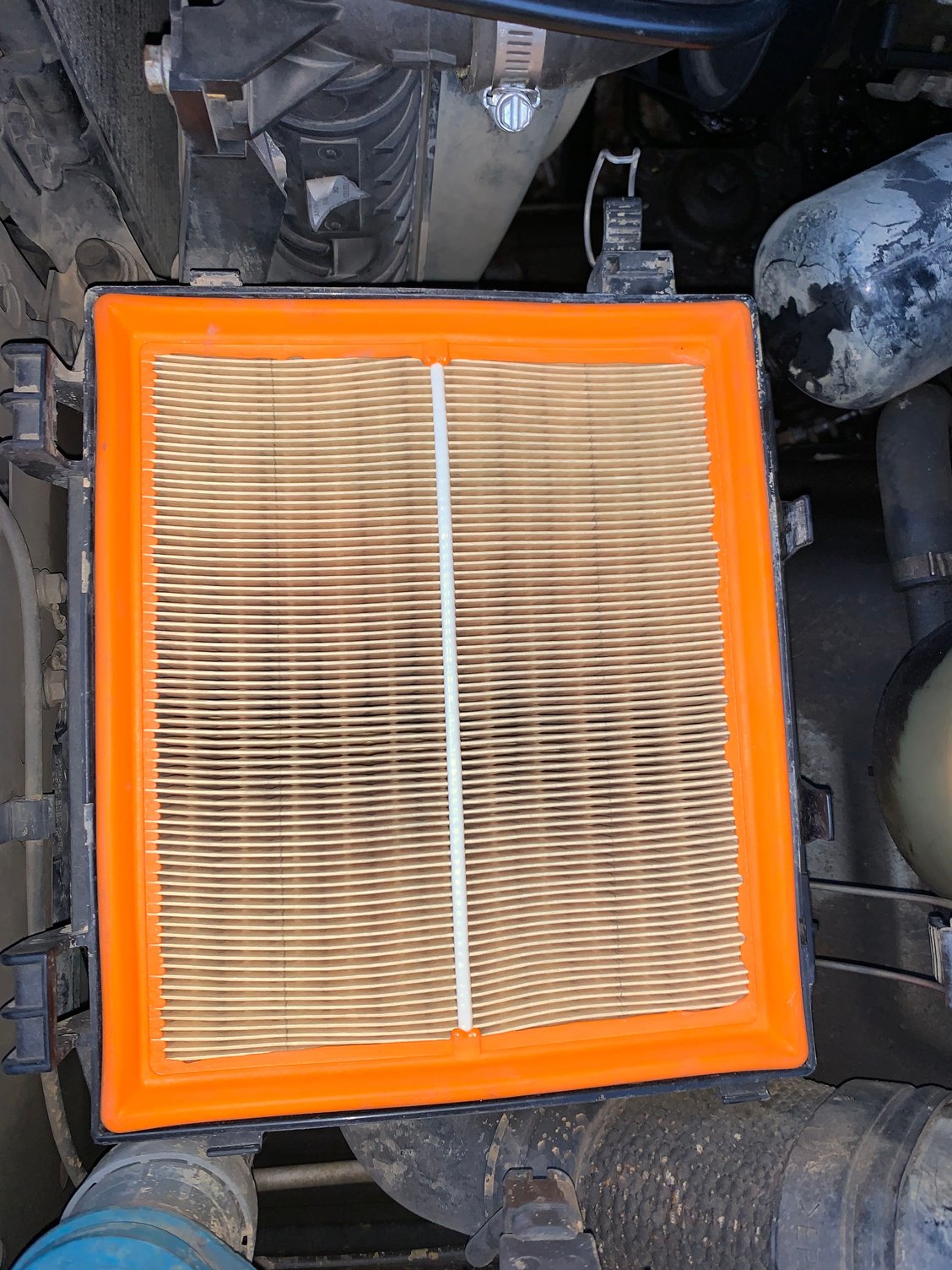

Air filter looks quite clean still - probably haven’t even put 5,000 miles on since last installed Sept 2019. Whatever that part is just below the opening of the air intake, it’s probably a little dirty too. I tried to clean up a bit.

Air filter looks ok - darkness is probably just an optical illusion created by the gills
Air filter looks clean Dried muddy water in air pipes - mass air flow pipe and part of air intake. I cleaned the air intake from the other side when I replaced the throttle body heater plate and took off the throttle body to clean it. I used throttle body cleaner or mineral spirits on the air intake - can’t remember now.
