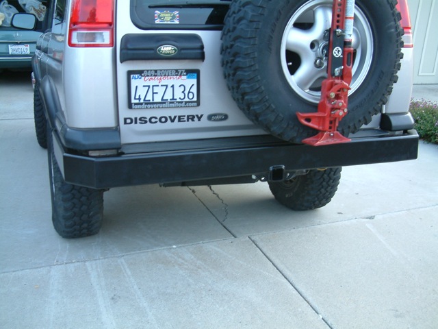

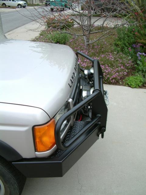

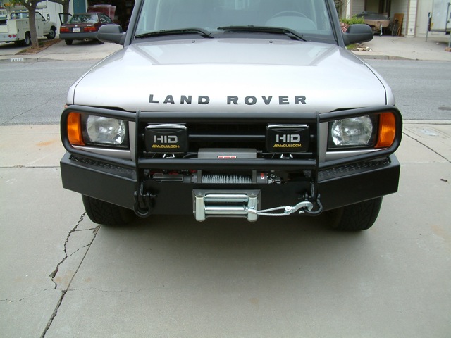

You can go to a site like this, Welcome to RTE Welding & Fabrication! , which makes by far the best front and rear bumpers or you could try Justin at Lucky8 LLC. You will find most to be very expensive and may want to consider making your own like what many of us have done. Here are a couple of pictures of my front and rear.

Like mike said, Rovertym. Also terrafirma makes one, but I've not seen it. Go over to discoweb and search for Greg Davis (I think?). He was making a rear bumper too.
