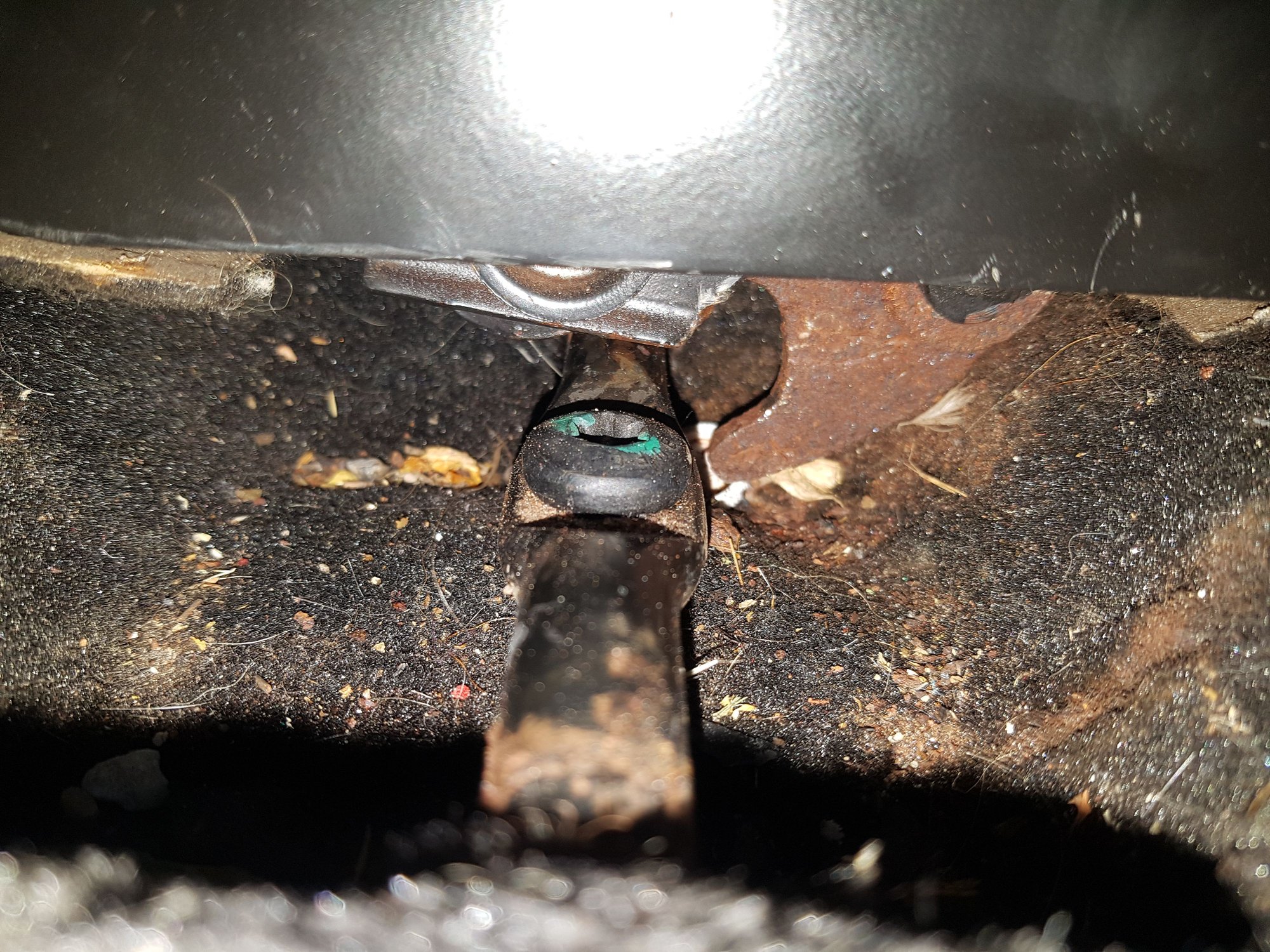

This hook does not respond to pulling the loop at all. I can pull the leftmost hook to release position using a tool, but when pressure is put on the seat the hook goes to a position I would call "mostly locked".
Upon further reflection, this hook looks like it is banging against the anchor point in the floor... thus this hook won't be able to lock at all. It's about 1/2 an inch from being in the correctly locked position.
The PO mentioned that this interior was recently installed, so is it possible that these seats were mounted incorrectly? Maybe this hook is misaligned?
Here's a picture of the leftmost hook. This is absolutely as far down as it will travel. It's in horrible condition, but that is from PO... I plan to take these seats out and fix the rust. And clean the whole car.

yes, could have been the install. It takes a bit to get the aligned correctly. or the release mechanism got damaged from install or prior accident, or it's rusted and stuck....
If you removes CAREFULLY the rear seat plastic cover (because getting replacement plastic pins is not easy), it will expose the lower this fiber board cover. If this is undone, you may have access to the release links/mechanism/cable...

As suggested, I exposed the area surrounding the middle hook. Unfortunately, there was still no visibility of the hook itself, just its metal casing. However, I did expose the two bolts that connected that casing to the seat. When looking at the hook from inside the trunk, they will be on the right side facing the right passenger door.
Using a ratchet with an extension (40 torx) I got them out fairly easily... I did have to leverage the seat up slightly in order to get a better angle, since the bolts are recessed underneath the carpet. Once I undid those bolts, the hook separated from the seat and I was able to remove it!
The problem? PO had only bolted the front torx bolts in and then tried to lock the seat down, resulting in misalignment. Not sure what he was thinking.
