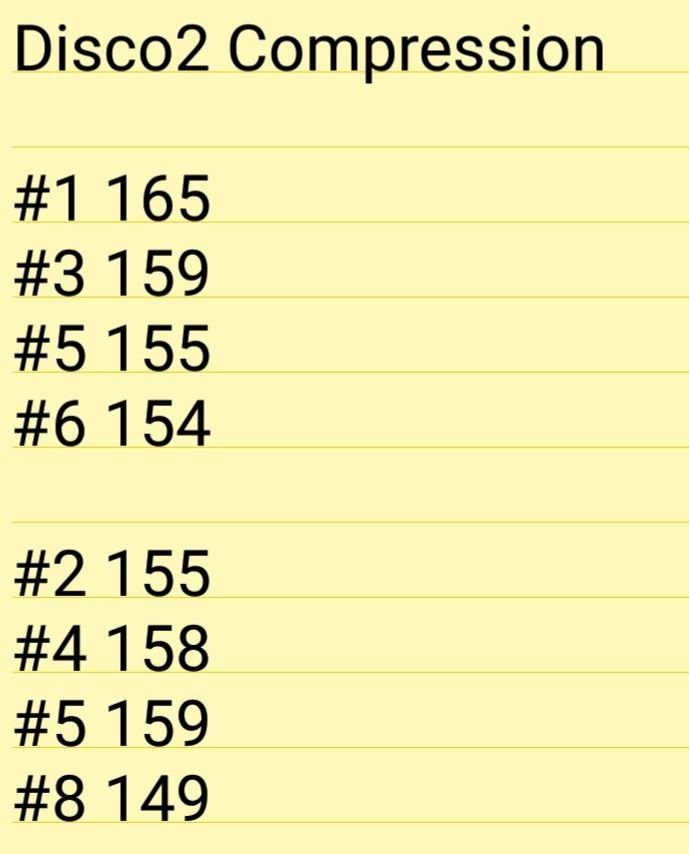

So I had misfires in Cylinders 5 and 8 and I discovered that both had wires that were bad. So I have replaced the wires and spark plugs. Now I'm getting misfires in 2 and 8. But when I put my spark adapter on them, they are both getting fire and the plugs are brand new. It is sputtering a and I can tell it's not firing, but my spark tester indicates that spark is getting to those plugs.
I've also added compression numbers I got today in all cylinders. 8 seems low and 1 seems high. But it shows there should be no worries of a head gasket problem, doesn't it?

8 and 7 most likely for blown HG. Low comp can be cause of misfire, but 2 and 8 are on the same coil and on the side of the internal winding on the coil. My guess is you have a bad coil.
