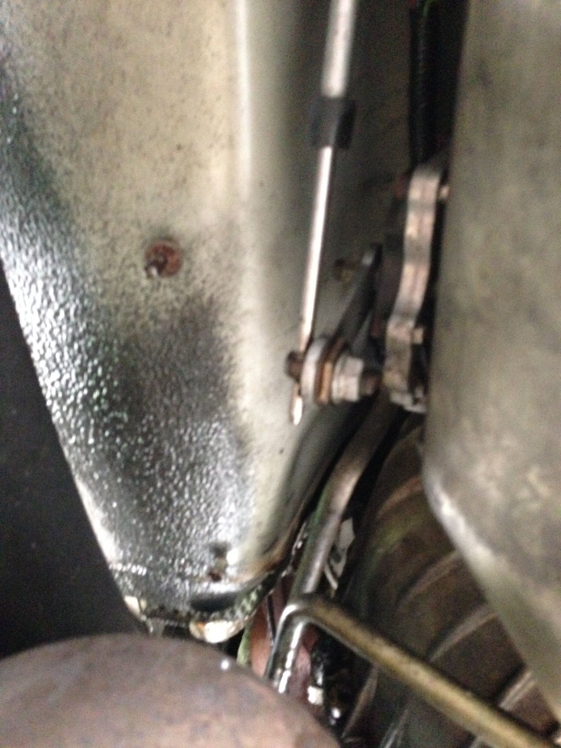

Update - I crawled up under there again and @Extinct is right - the muffler is too far back. I traced up towards the front and found a spot around the driver CAT that seems like a heat shield is missing. Got a new Design Engineering heat shield coming from Amazon on Wednesday so I will slap that in there and see if that helps.
Seems like there used to be something here as evident by the studs.

Not a great pic angle but yeah, you could use a heat shield with an air gap around the top of your cats.
Even so, your muffler temp readings suggest a problem upstream of the muffler. Cats might hit 350 but your muffler shouldn't. Certainly not 405.
Heck, I'm rethinking. Now I'm wondering if that shiny surface is not just a wierd pic angle/lighting but some sort of heat wrap around the cat itself (a pure fire danger if someone did that).

I mispoke - the driver side CAT has a heat shield in place but the spot above it in the picture does not have any shielding. It looks like there used to be something there and that is what I am going to replace.
