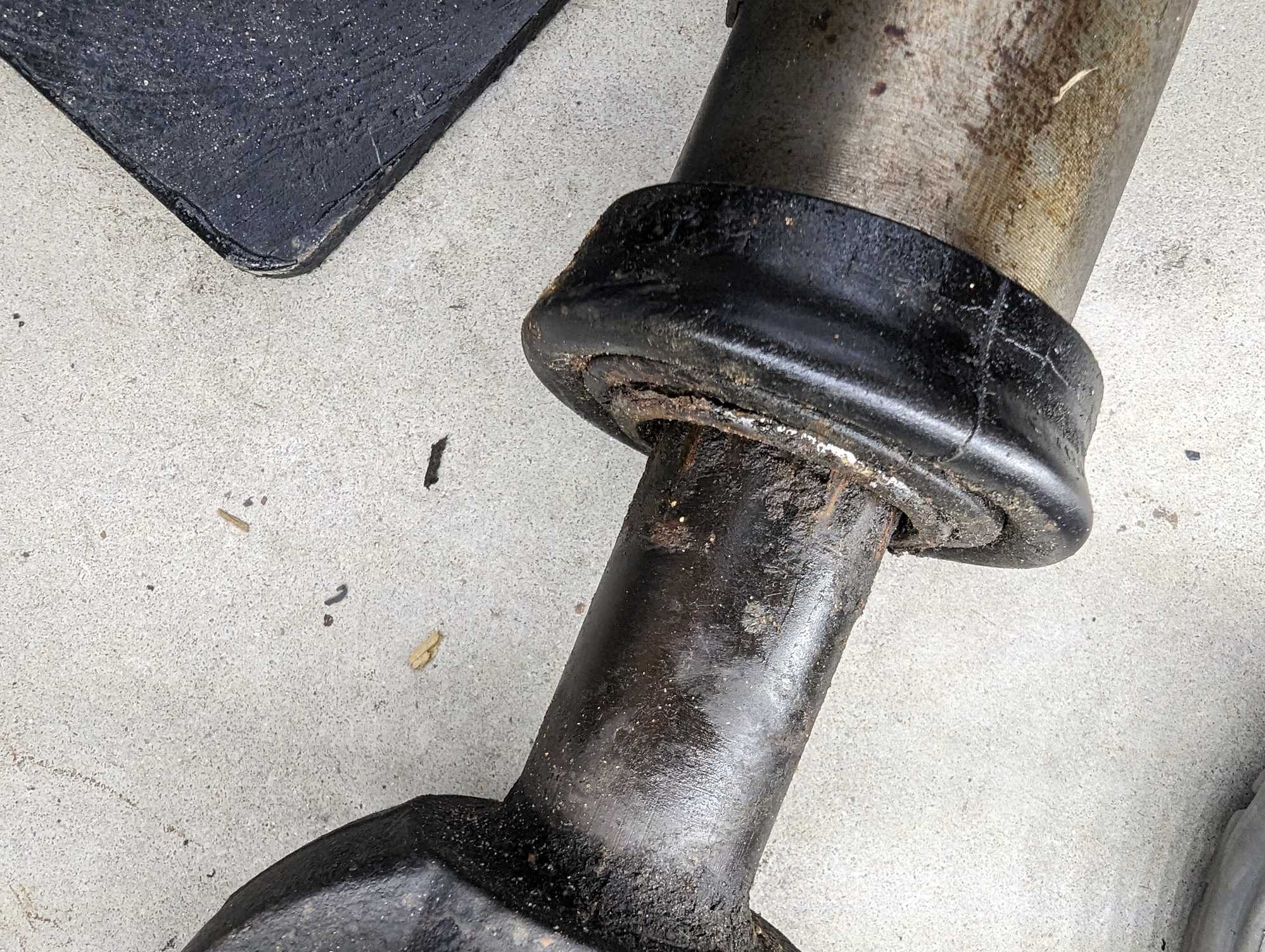

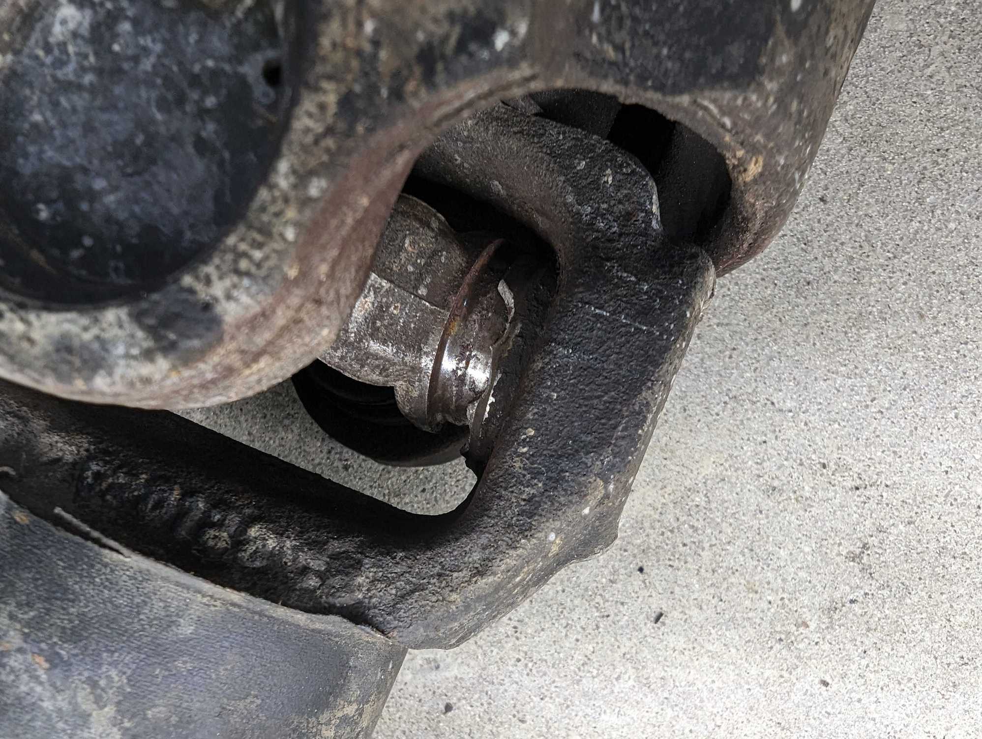

For anyone wondering what are some signs your front DS might be going bad I have some pics of mine to share. The slip joint was also seized and was pushing the rest of the drivetrain around instead.

wow. That was almost not a lot of fun.

Wow indeed. Looks like you caught it just in time. I would suggest that anyone needing a new stock driveshaft take their factory unit to a driveshaft shop and have it rebuilt. The stuff coming out of China is poor quality and won't last, I speak from experience. The alternative is Tom Woods or GBR Utah, which you should look into for offload or HD/lifted applications, but you should be able to get the factory shaft rebuilt for considerably less. Get greasable u-joints and a greasable center bearing in the double cardon. And it's also worth requesting u-joints that are greasable from the ends of the joints rather than the middle because it's much easier to grease in situ. The center bearing is tough regardless, but better have one PITA than all four.

Yeah it was pretty close. I already have a medium duty unit from Lucky8 here so I'm going to throw that in. I may rebuild the factory unit either as a back up or to put back in and keep the L8 one for back up duty. Just glad it didn't explode on my way home the day I bought it.
