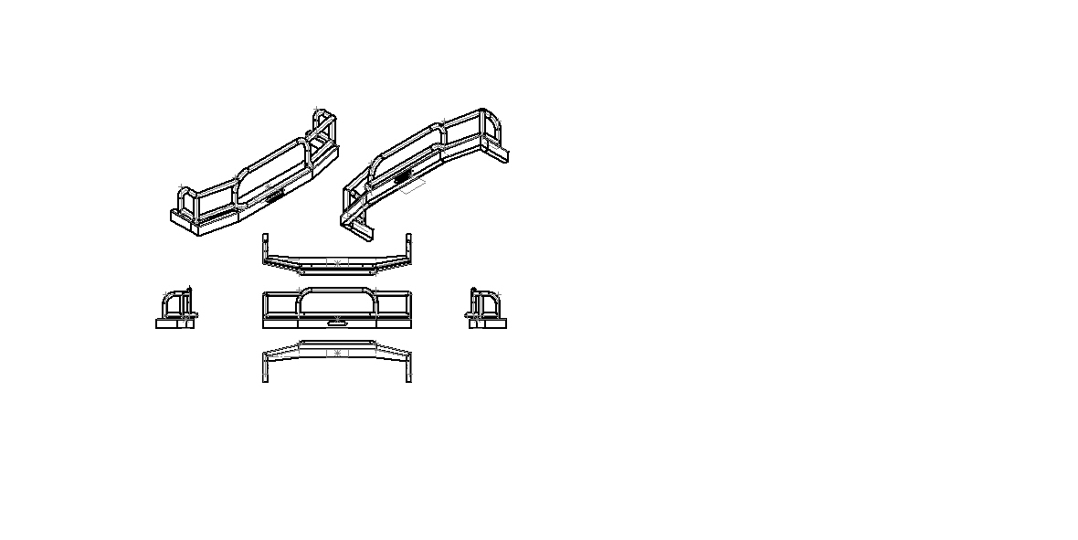

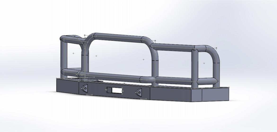

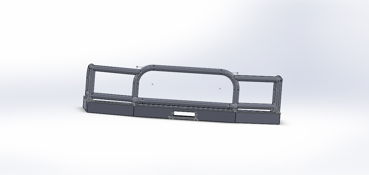

I just started learning this 3D rendering program, and I thought there was no better way to learn than to just to try drawing stuff for my D2, it definitely kept me motivated. Anywho, I've designed a few so far, but I like this one the most as of now. It's kind've a mix of a between few bumpers that I thought looked nice.
Its to scale, the base of it will only stick off the front grille about 6'', the bull bar wraps around to the blinkers, I put a light bar that comes out a little so the lights will be flush with the bull bar, and I'm probably forgetting something also...
I'm still going to add a winch tray, cut out the top a little to fit a winch, 2 support beams from left to right, and possibly some tabs for limb risers, any other recommendations would be cool too.
Tell me what you think.

Looks Good! Very similar to ARB's BullBar. Don't forget to add cutouts for the directionals and foglights (optional).
What CAD program are you working with?

Also the area or holes to mount/weld on recovery eyes.
I like where you're going with it, perhaps a few more angles tapering down would be nice.

Coors: I'm working with solidworks, it was a pita to get used to but I'm getting it now, my dad just downloaded it on my computer and told me to mess around with it lol.
ZgPhoto: Where do you think tapered angles would look good? And I totally forgot about there recovery points also :O

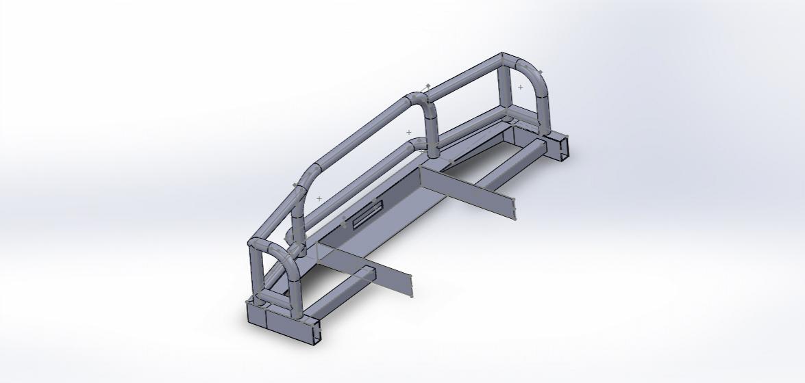

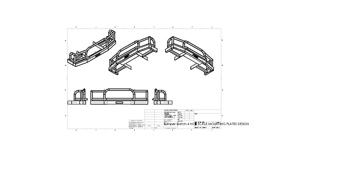

UPDATED:
-I put 2 D-Ring recovery shackle mounts on the front that will fit a 3/4 shackle.
-Winch tray is incorporated now
-I added the cross members onto where the 1/4'' steel plate will mount to the bumper.
It's still not finished, the two thinner plates you see are going to have another plate from left to right which will then mount to another piece which is mounted to frame. Also the my mount plate isn't to scale yet, when I pull my bumper off, its off for good. So I'm waiting until I have everything lined up with laser cutting and shop time to pull it off.

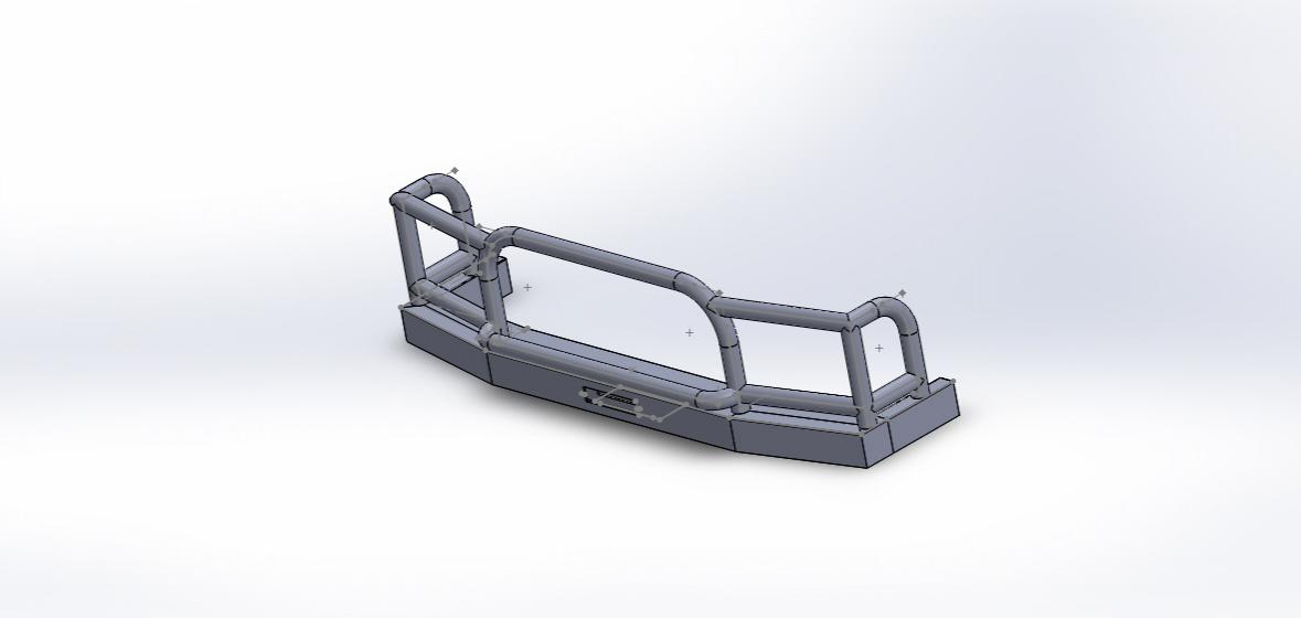

Forgot to show recovery point mounts... anywho, I must now run to class before I'm late
