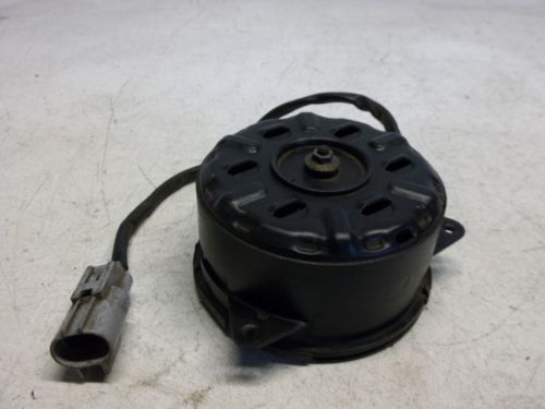

The exact fan I used ($26 shipped):
Toyota does have a dual fan setup though, with 2 different motors, so be sure you get the correct one (I think this is the left side fan motor).
