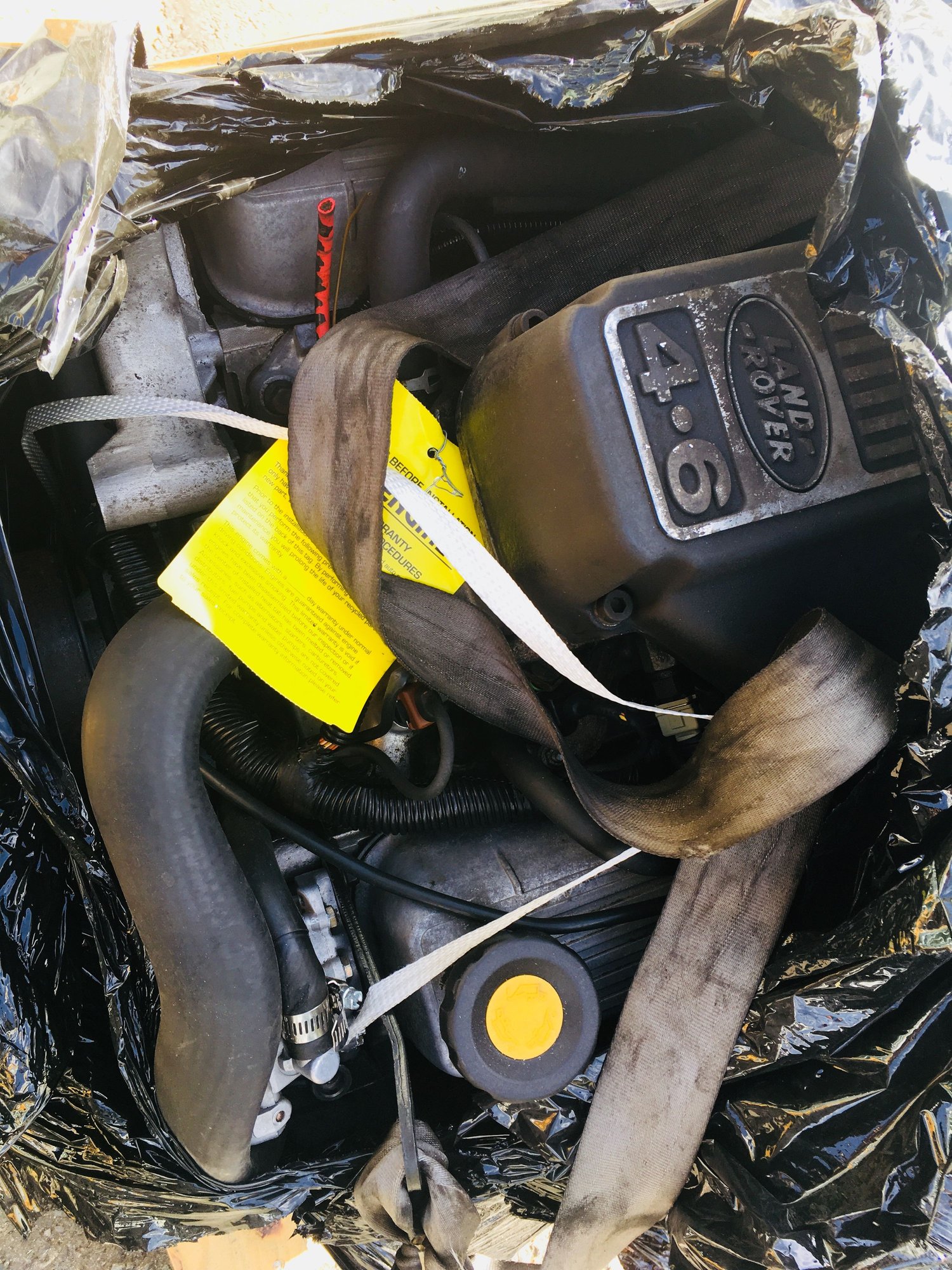

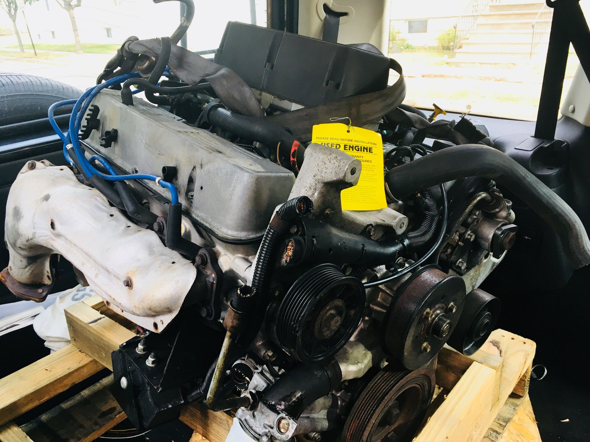

Soon after install, The new engine arrived and I picked up from my friends business that allows freight shipments. Purchased an engine hoist and engine stand from Harbor Freight to get it out from my disco.
Examined the newly arrived engine, removed the intake and exhaust manifolds and the cylinder head. The engine looked okay and no steam cleaned pistons heads that resembles like my cylinder #6.

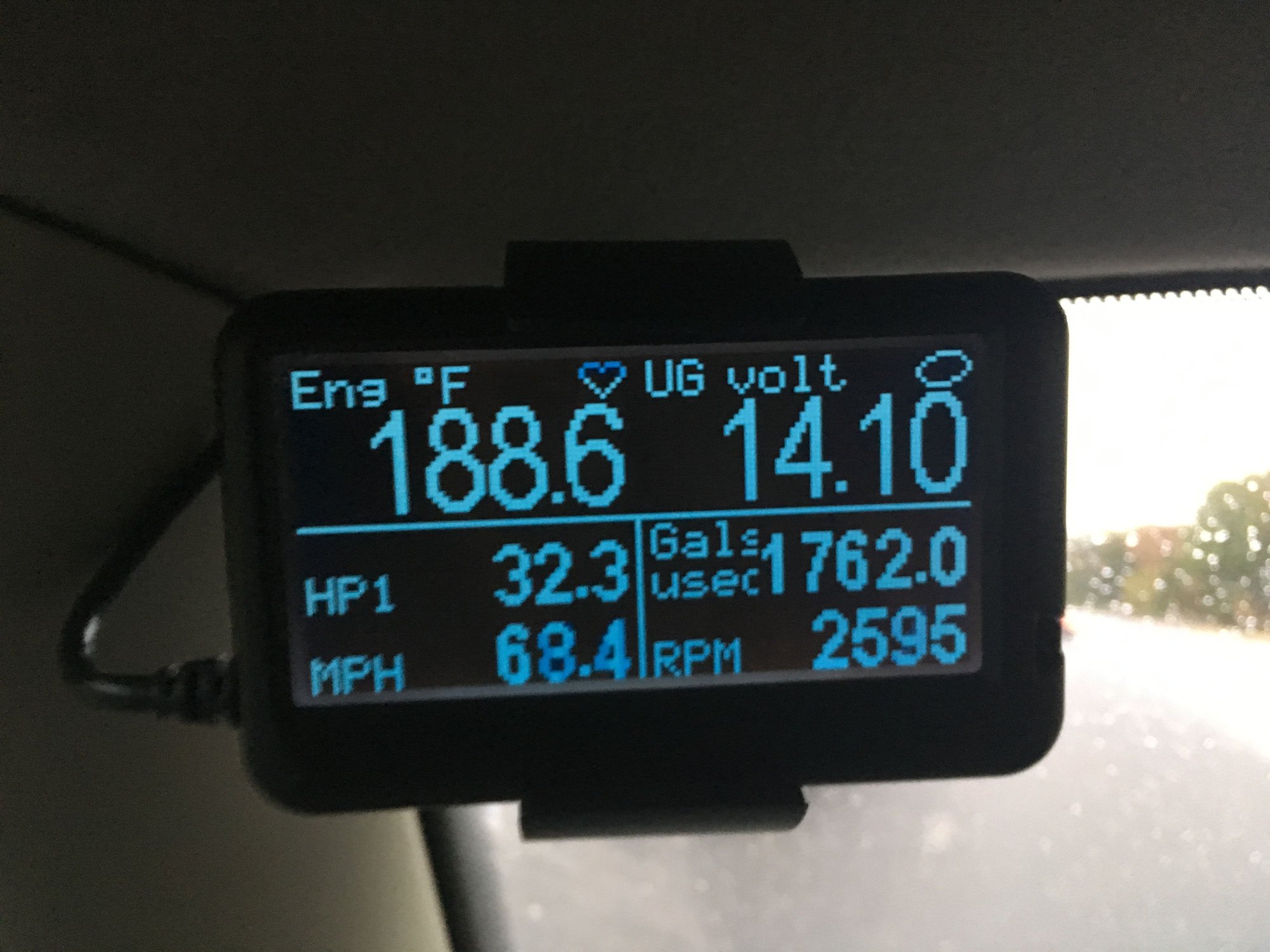

I got so excited starting with the project and ordered new gaskets and head bolts, etc. Meanwhile, the other truck was running already and and thought of taking it for a ride around the block. Test drove the truck and monitor the heat via Ultragauge. It was steadily rising and drove home immediately.

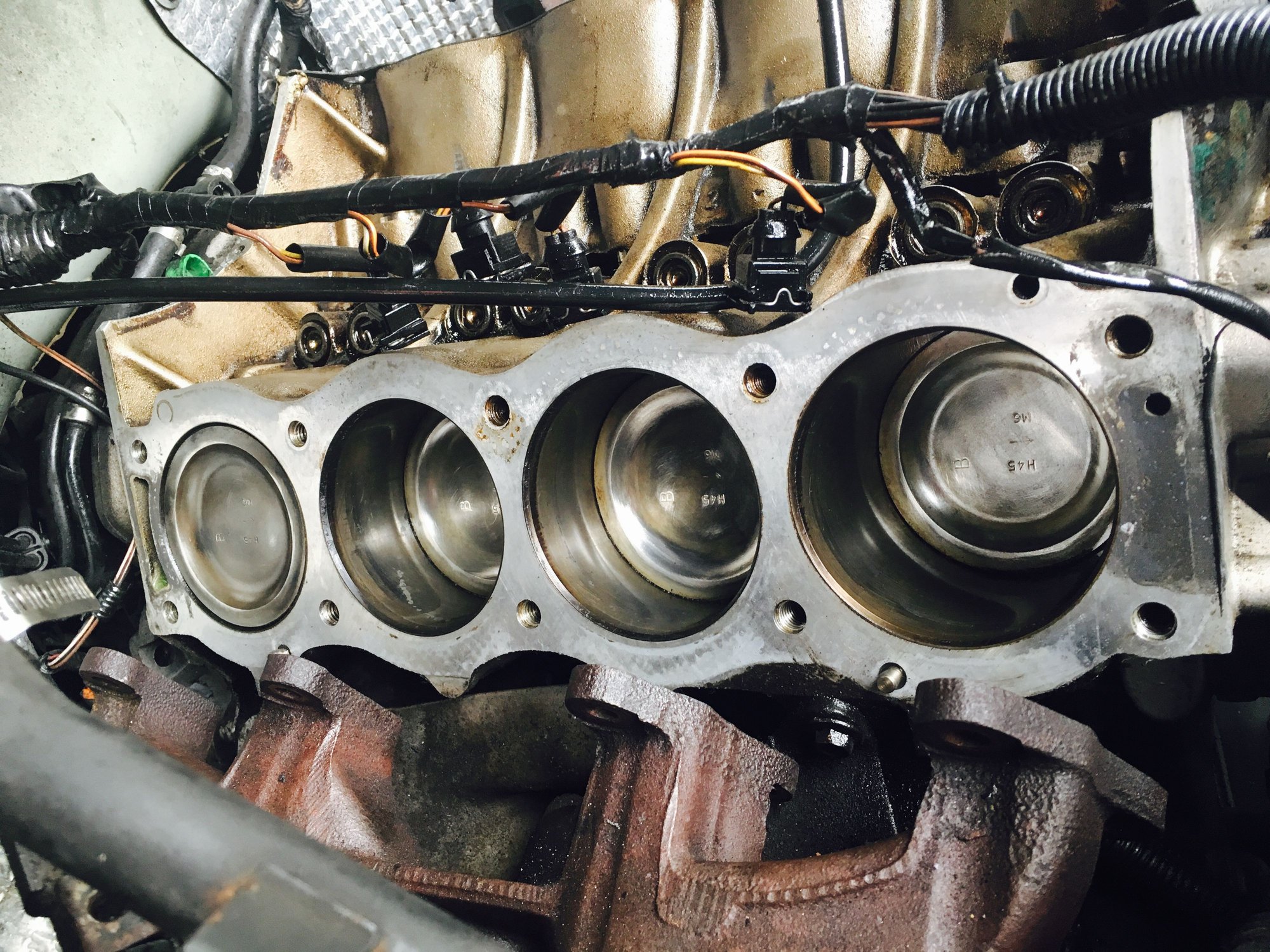

Stumped with the overheating temperatures, I thought of the blocked thermostat that I might have installed. But, also wondering the coolant pressure was way extreme and it was boiling out of the reservoir. So I replaced with another thermostat and still overflowing and bigger bubbles coming out at first start when engine was cold. So, I removed the plug from the #4,6,8 cylinders to confirm and check the condition and here is the photo what I saw in the cylinder #6
Coolant inside #6 cylinder.
So, I then assumed that there was a crack in there somewhere. How large? I dont know. No sign of coolant in oil, no sign of oil in coolant.

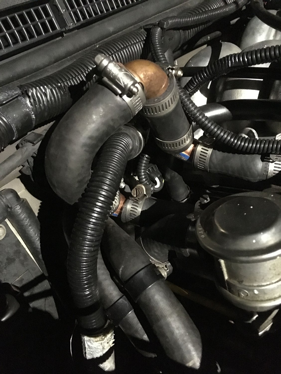

At this point, I have a spare engine ready to install. Well, all plans changed when I decided to experiment on this instead. I have an old radiator that was leaking and do some extra coolant plumbing hack. So run to home depot and got some copper elbows and went to Auto Zone to get a foot of 3/4 inch coolant hose and some clamps. I bypassed the heater core.

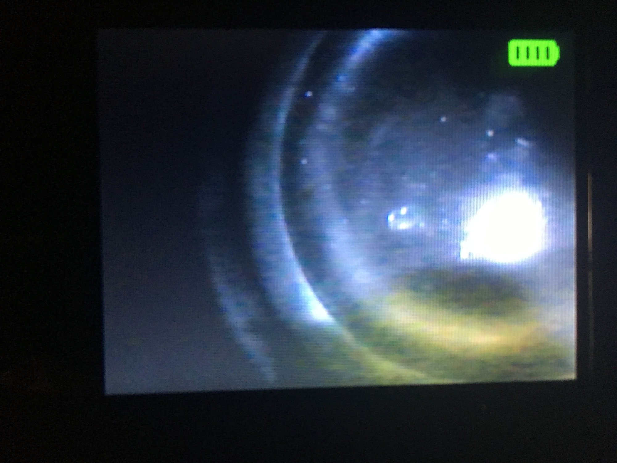

Then installed the old radiator and happily added stop leak! Yes, that right, STOP LEAK, what to loose. I have a spare engine. Noooooooo! I know, all of us here are against any clogging agent that could lead for more clog. But, I need to see this clog works. Then, I added the clogger to the coolant and with no result. So I drained all the green coolant and replace it with tap H2O. I was thinking that water will evaporate faster than regular coolant and might patch the crack faster. Several attempts were made in 10, 15 minutes intervals and watch how the temperature rise slowly. Truck wont stay not to over heat in the recommended period of time for the chemical to cure. 3rd attempt, double the dosage and bang. Truck started to normalize. Temperature on the high side and no overheating. Let it sit overnight and checked the #6 cylinder with scope and here is the image.
Take some few rounds around the block and temperature, steadily going back to normal. After several days of test driving the truck with a total of more than 270 ++ miles driven, temperature went back to normal. No misfire codes on cylinder #6, engine smoother and no hesitation at the moment.
