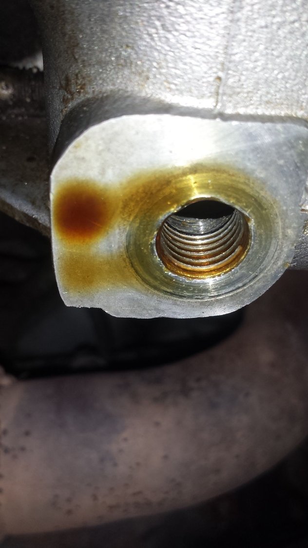

well looks like the good guys at Firestone left me with a stripped oil pan. pulled the plug today and normally ones u make it past the initial quarter or half turn to loosen the drain plug with the wrench, you should be able to un-thread it easily by hand. not the case with this plug, had to use the socket wrench to loosen the plug the rest of the way out of the pan.
Plug and the washer on the left was what they used and the washer on the right I got from a euro shop in North dallas. U can also see the partial metal thread on the paper towel that was on the tip of the drain plug. Second pic u can see the threads r missing at the end. And actually I was able to push those threads around in the hole.

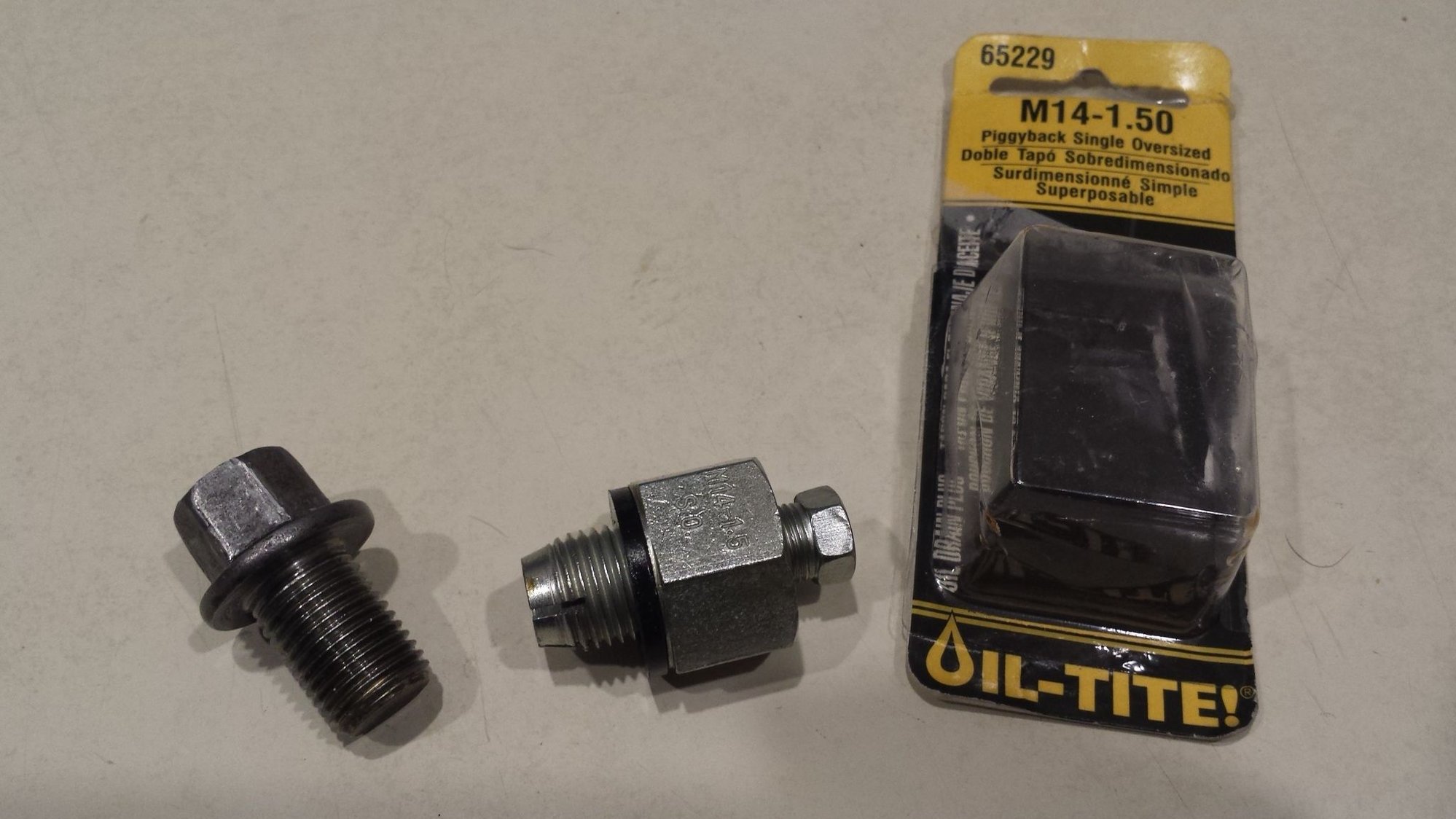

so what fixes can you guys recommend? i was thinking of jb welding in one on of these (https://www.fumotooildrainvalve.com/...FQIcaQodLY4Nzw)
what have others done?
here is a neat option that the guys at Jeg's recommended (http://www.jegs.com/i/Dorman/326/092...FQqoaQod2kANHg) or they also told me to check out the local auto parts stores for a similar part.

Found this tonight at the local auto parts store. Maybe give it a try.
