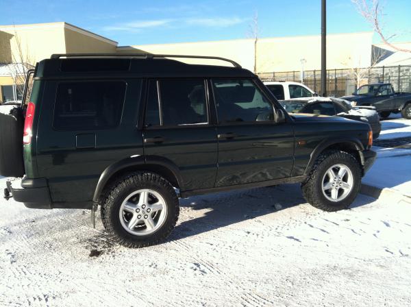

I am running 275/65/r18 Duratracs, stock 18" wheels, on a 3" RTE lift. Had to buy wheel spacers, still get a little wheel rub if you crank it all the way to left or right. No problem on the articulation, did not have to trim anything.
Been really happy with the tires. Excellent in the snow and rain. Noise isn't bad at all either. (They are really solid and heavy)

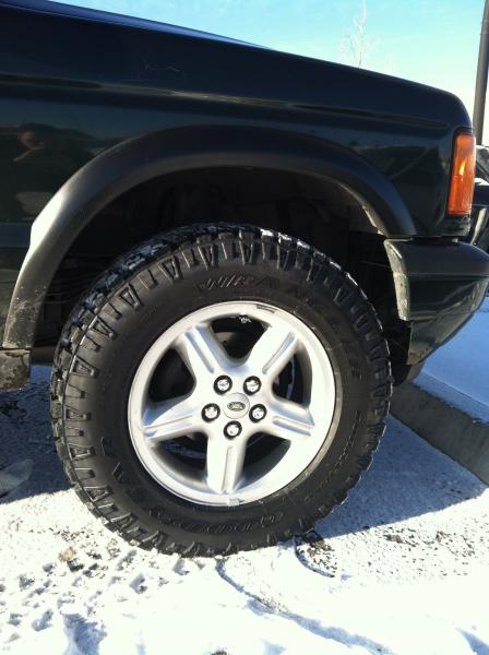

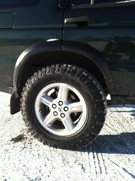

Here are some pics of mine. Like I said, this is a with a 2" OME heavy duty lift with 275/65/18s. You can see the front bumper where I trimmed it just a smidge.
