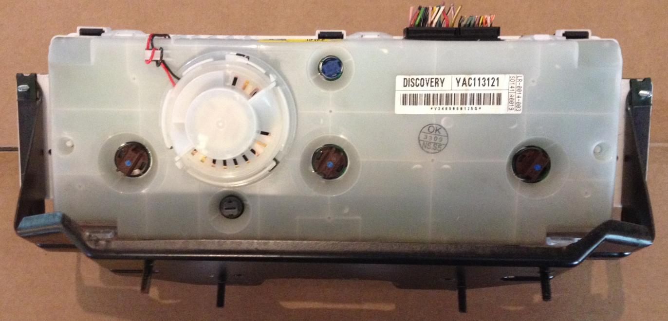

It's not as easy to remove the bulbs on a DII as is is on a DI or RRC. The only bulbs you have access to are for the four major gauges and the odometer. There are plenty of reasons why the bezel was removed at some point over the last ten years ranging from replacing one of those five bulbs to more serious work like replacing an ignition switch assembly. It's easier and cleaner with the bezel off to access the shear bolts.
