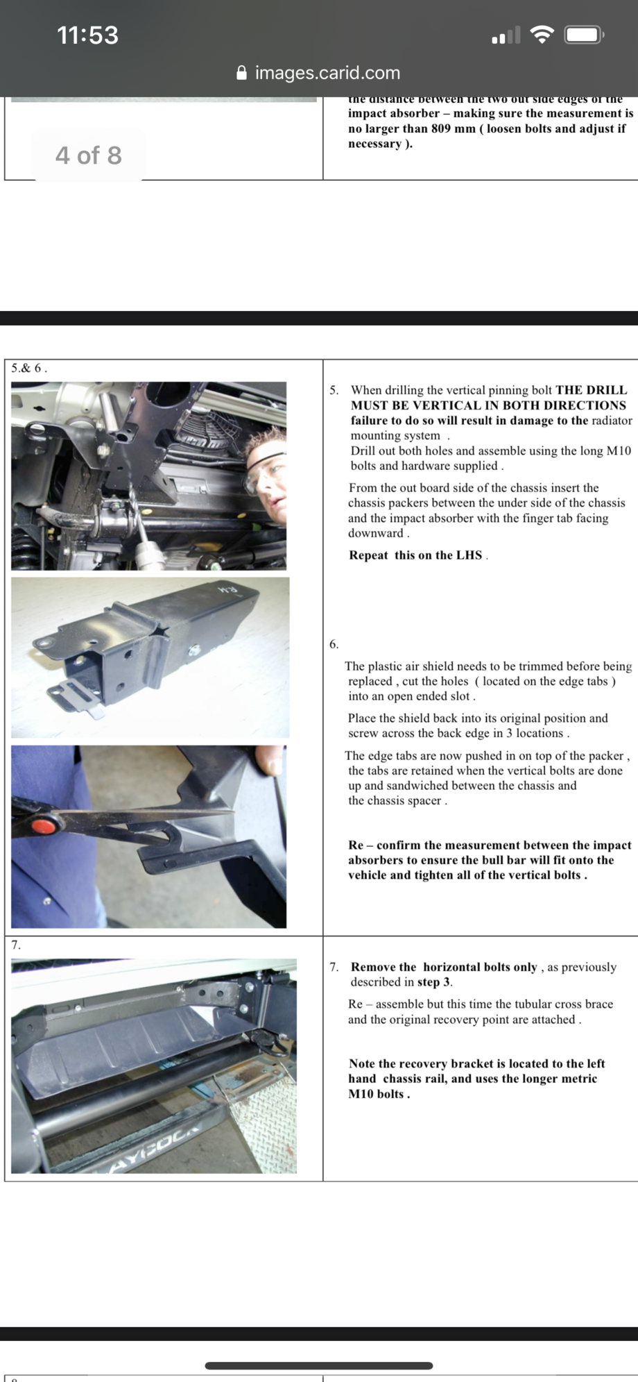

I’m not the most mechanically inclined and I did the bumper myself. There are videos of how to remove the bumper also the workshop manual and just get someone to help or use a floor jack to position the bumper, you need to get the right drill bit I think it’s a 10mmx130mm and drill the holes and put the bolts in and you are done it’s super simple. I would never pay close to 1k for someone to do what I did in about an hour that’s highway robbery, if you want since I did the install like 2 weeks ago I can help with any questions you may have
You drilled holes? Why? Mine bolted right up with zero modification to the bumper and frame.
03-04 needs pinning bolts through frame
