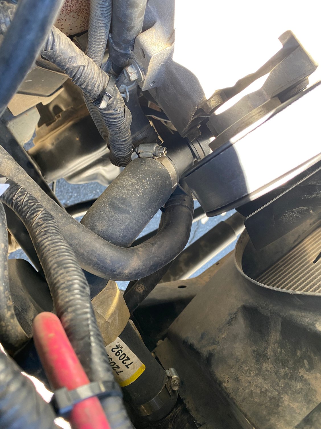

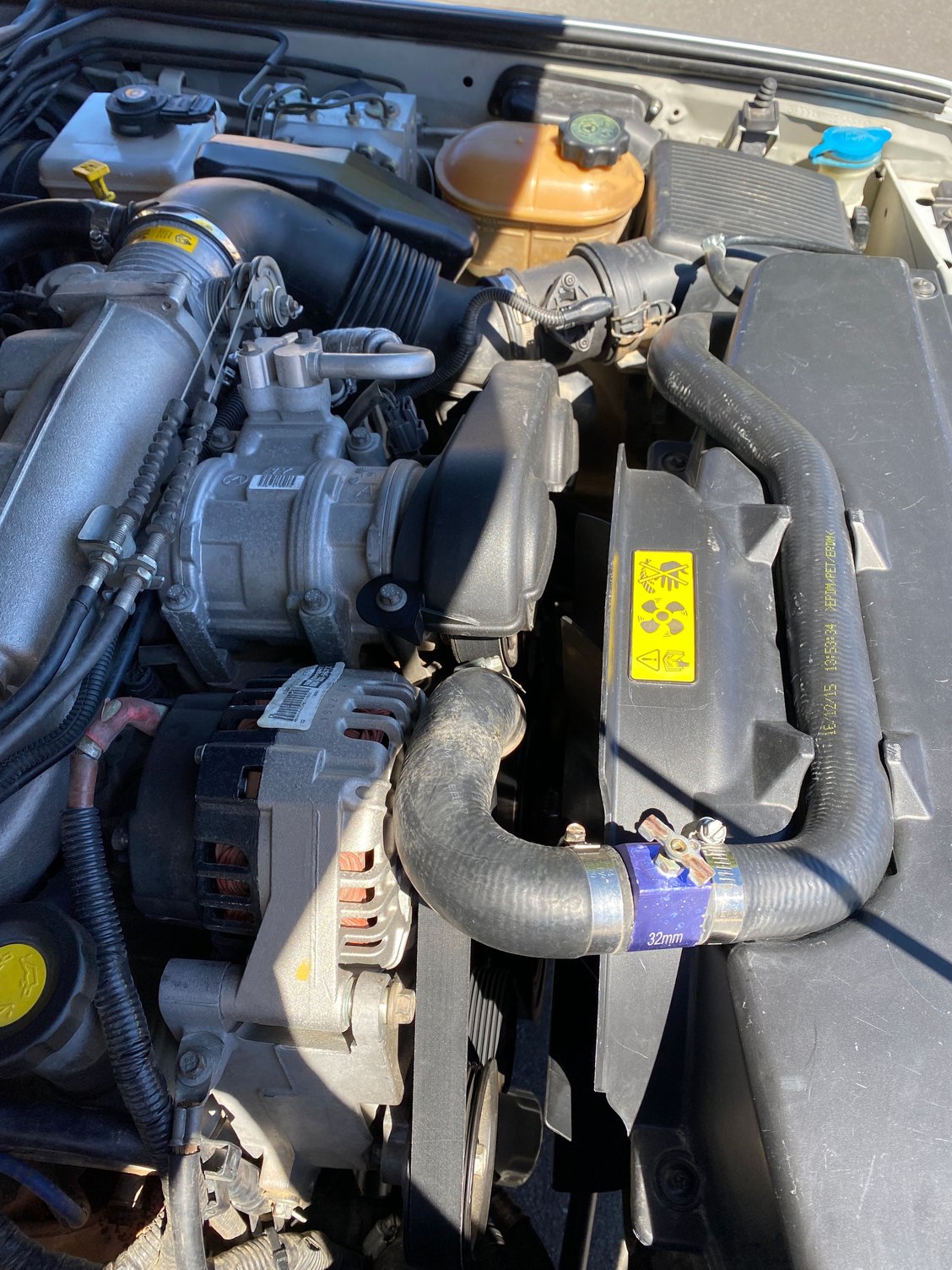

Thr inline mod will fit right where the blue bit is
So i would add a Tstat in the yellow circle area??? any kit or hose i need to purchase to add the mod?
thanks

@davidpx858 Nope you just remove the blue bit and put the thermostat and housing in it's place

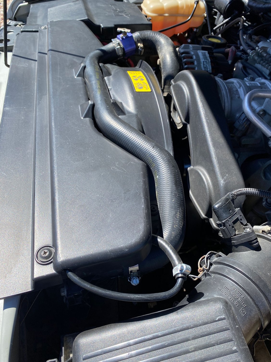

He still needs somewhere to bleed it.
I'de put the inline thermostat where the bleeder is now, and the bleeder where the yellow circle on the picture is.
