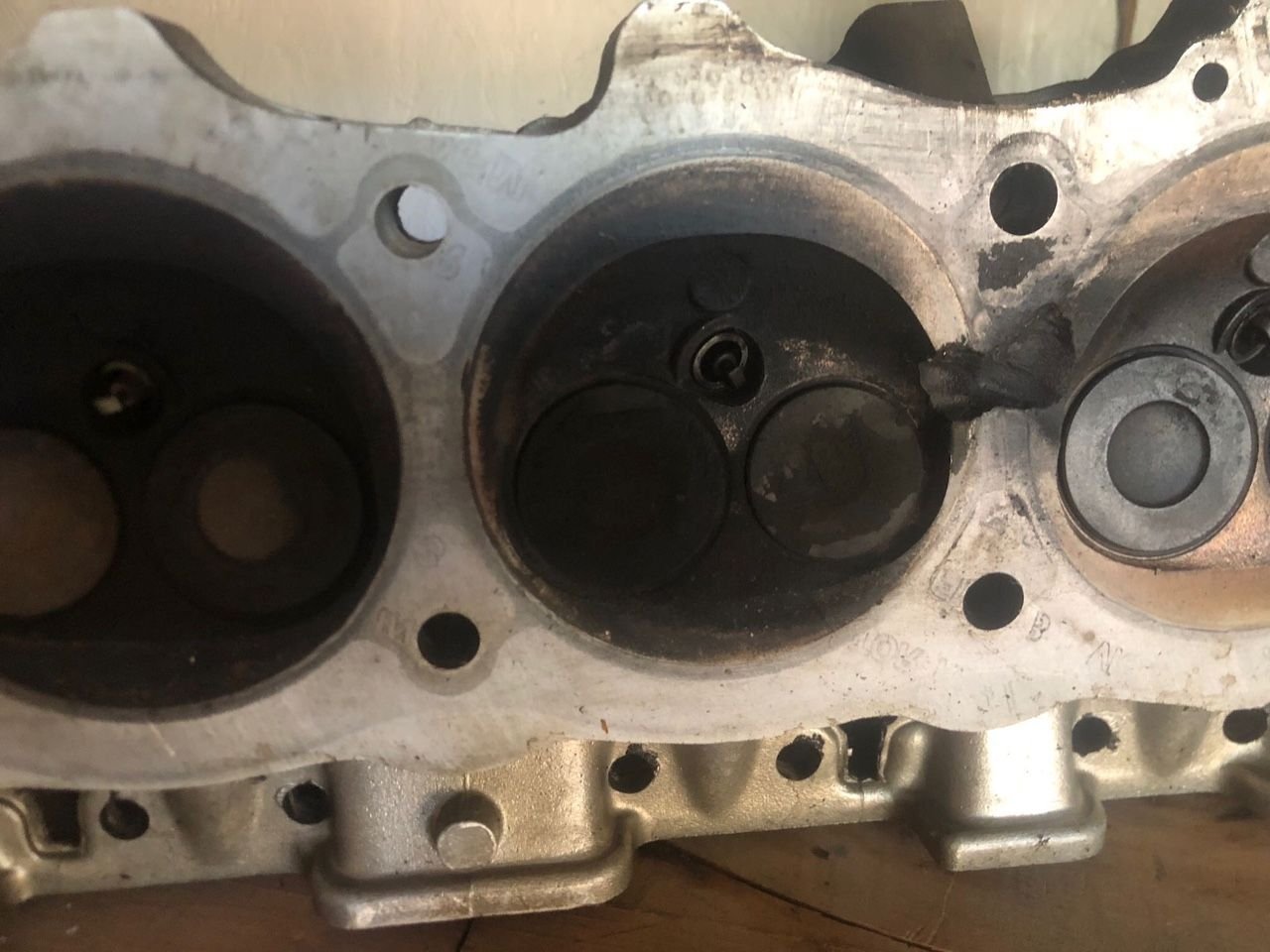

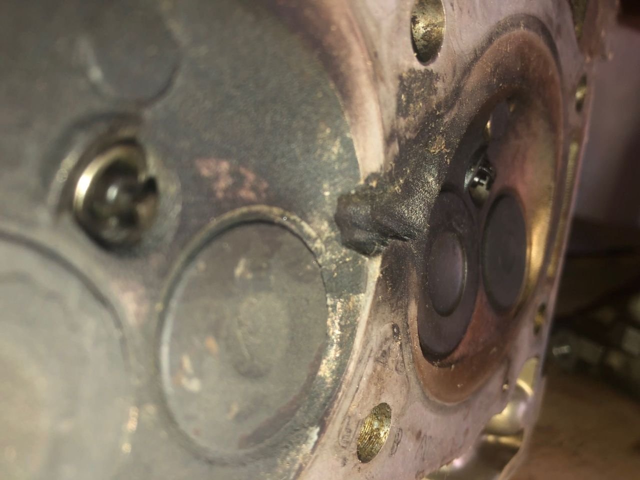

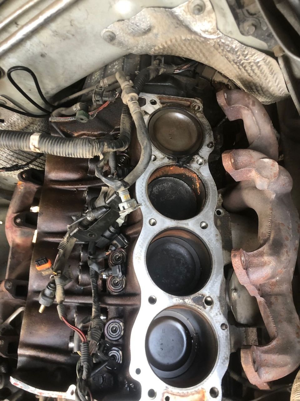

My 2004 land rover discovery needs a new engine due to a gouge in the block and head. I am trying to find some on ebay that I can have shipped. Is it ok if I get an engine without secondary air injection? The current one has secondary air. It is possible to retrofit the new engine with secondary air using the parts, or are the heads different. I live in an area in California that only requires emissions testing when buying/selling a car. What other places can I get an engine? Are there other engine models that fit?

The OP wrote surfaces of both the block and head were gouged, so reusing the heads is a problem.
That said, I recall reading posts describing new metal being welded into mating surfaces of damaged blocks and/or heads and then milled flat. That may be an opportunity here, depending on resources available to the OP.

Here are some images of the block and head. Not sure if the metal welding and smoothing will work.
