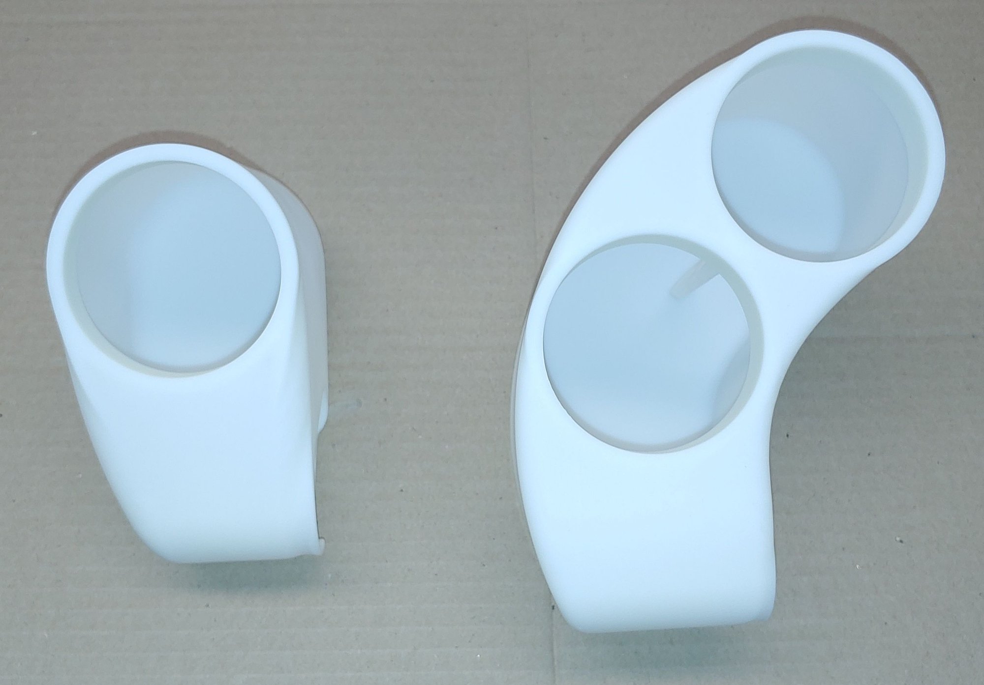

Along the way I decided I wanted a nice looking gauge pod to put my fan controller/gauge in so I made some of those two, also in the links.

Also, have not checked the fit of the gauge pod to the D1 or classic binnacle but I have a more straight up pod that would work for both of those (on the left).

As far as the gauge pod and binnacle, if you want to try one and test on a D1 or Classic I will be willing to discuss a beta tester arrangement to get some feedback and we can make a set to work with those trucks.
