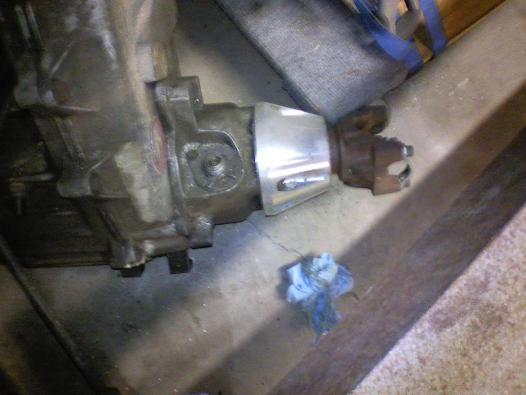

The driving force in this swap started with my dad wanting to give up his trusty ol rusty pickup. He owns a 2003 Silverado with a 4.8 that has 140,000 miles on it. The truck has been babied all its life, but he lives on a gravel road so the body looks like swiss cheese. I'll be buying the truck next weekend for next to nothing and will probably drive it for a while. It runs, shifts and operates perfectly. I also happen to own a NP241C from an older gm pickup that is passenger drop and has a fixed output yoke on it that was custom built by a machinist. The case was originally on an NV3500 that was mounted to an Isuzu diesel motor that powered a full size Jeep Cherokee...but that's a whole other story. There will be a few small issues to work out with this case, but from what I can tell, it should mount to the tranny and it already has a VSS tail housing.

Phase 3 will be the tear down and swap...this will most likely happen when one of two things happens...1) the frame on the pickup finally rusts through...though despite the body rust, it seems pretty solid. OR 2.) The Rover engine gives up the ghost. Hopefully by then, I will have accumulated the parts I need and some more knowledge. I feel fully capable of doing the wiring myself and will be starting with complete harnesses and ALL of the parts I need from the donor. I've also included a picture of my 241...the only catch is that the transfer case is still in the garage of the house that we own in New York, and I'm in Iowa. Hopefully none of our tenants have sold it, and hopefully we can pick it up when I'm there in June.
