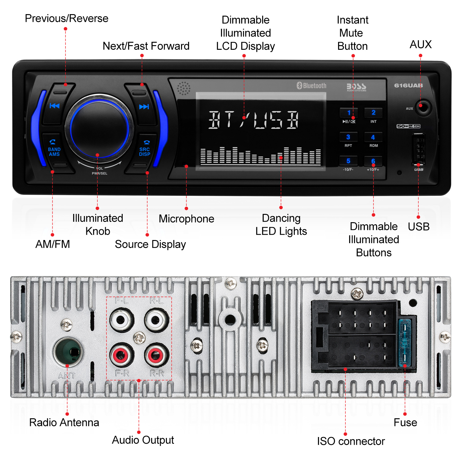

It's this one, well a variation but the outputs are the same: https://catalog.bossaudio.com/Boss-A...d-Units/616UAB
These are the outputs:
I'm using the ISO connector directly from the car
EDIT: I realised you probably mean is the output of the sound balanced left and right, in which case yes it is. I can also mess with the balance on the head unit from left to right and front to back without any issue
Balanced outputs explained: https://www.aviom.com/blog/balanced-vs-unbalanced/
The factory head unit as well as the factory amp use balanced lines, so you need a unit with balanced outputs to properly drive the balanced inputs of the amp. If you have a mismatch, you will get noise issues definitely.
The BOSS unit has speaker outputs (8 pin ISO) and unbalanced outputs (RCA), but no balanced outputs. It looks like you connected the speaker outputs to the factory amp input, which creates a pool of problems (impedance & voltage mismatch as well as noise from the internal digital power amp) and then causes the noise. You need an adapter with integrated filters to correct this.

I was wondering if this was possibly happening, but I'm not sure how as I used the stock connectors, its wired the same way the stock head unit was with exception of the three coloured plugs and the second antenna. I'm assuming the three coloured connectors are for wheel controls, but maybe thats wrong?
The top connector is for the speakers. The plug should be brown. The RCA connectors on your unit are amplified outputs for if you don't have a separate amp.
In the pictures you posted, the pins in the other connector (grey plug) don't include anything for steering wheel controls. That head unit only has permanent power, aux power, ground, and system enable pins.

ISO connector outputs are amplified. RCA connectors are line outputs to be connected to an amplifier with line inputs.
