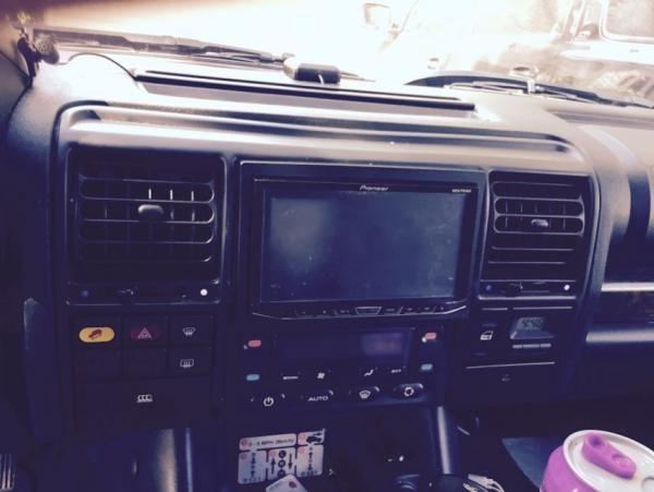

Robert Booth and I both did surgery on our dash fascia and installed 2-din Pioneer head units. They have navigation, bluetooth, 2 usb ports, sdcard, hdmi input, aux rca inputs, 3.5mm inputs, sirius/xm input, dual-zone audio/video outputs for rear screen/headrest monitors, rear view camera input, hdradio, DVD/CD. Roberts install looks better than mine, but I am happy with mine. I kept all the factory amp, speakers, wiring,etc. just added a mono bloc amp and 10" sub for a little bump.
Double Din Pioneer AVH4000NEX
