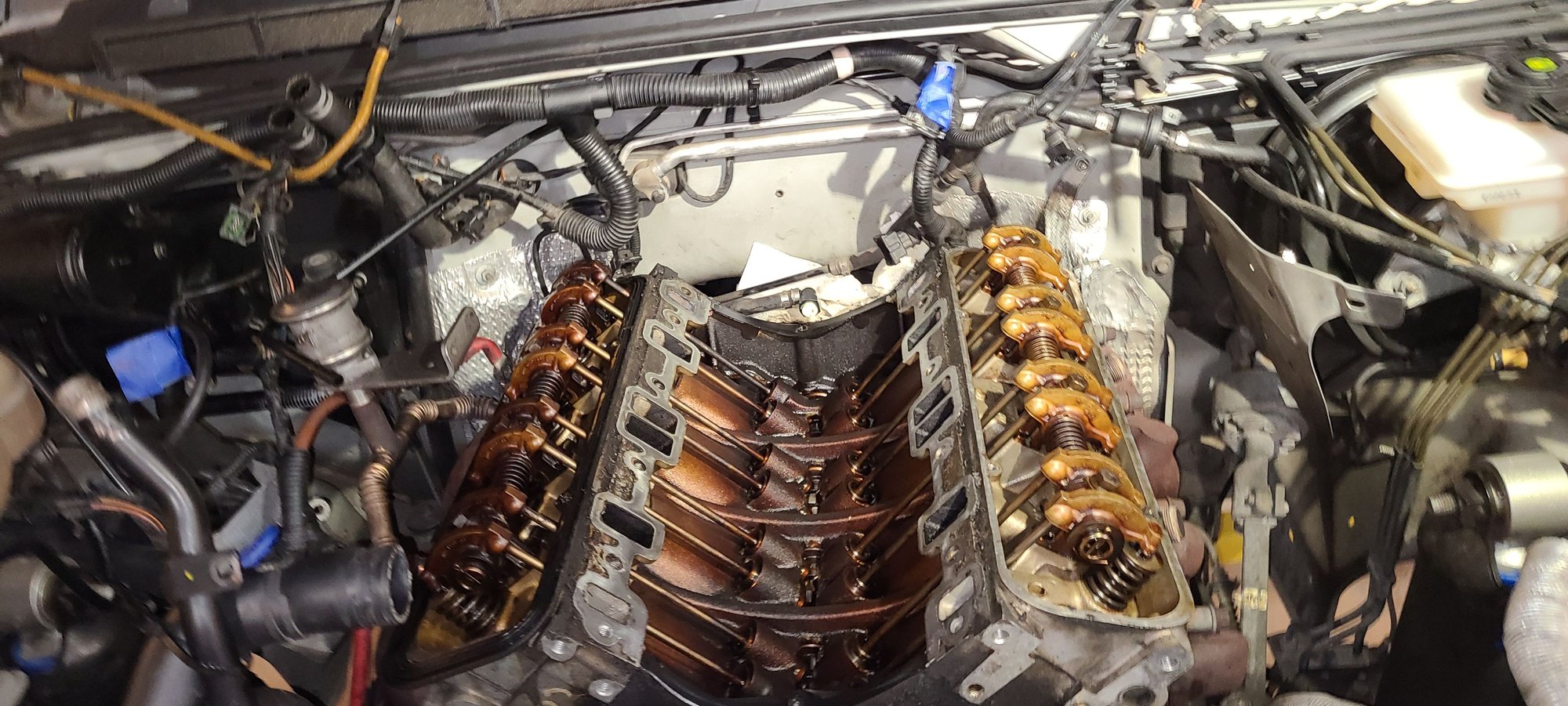

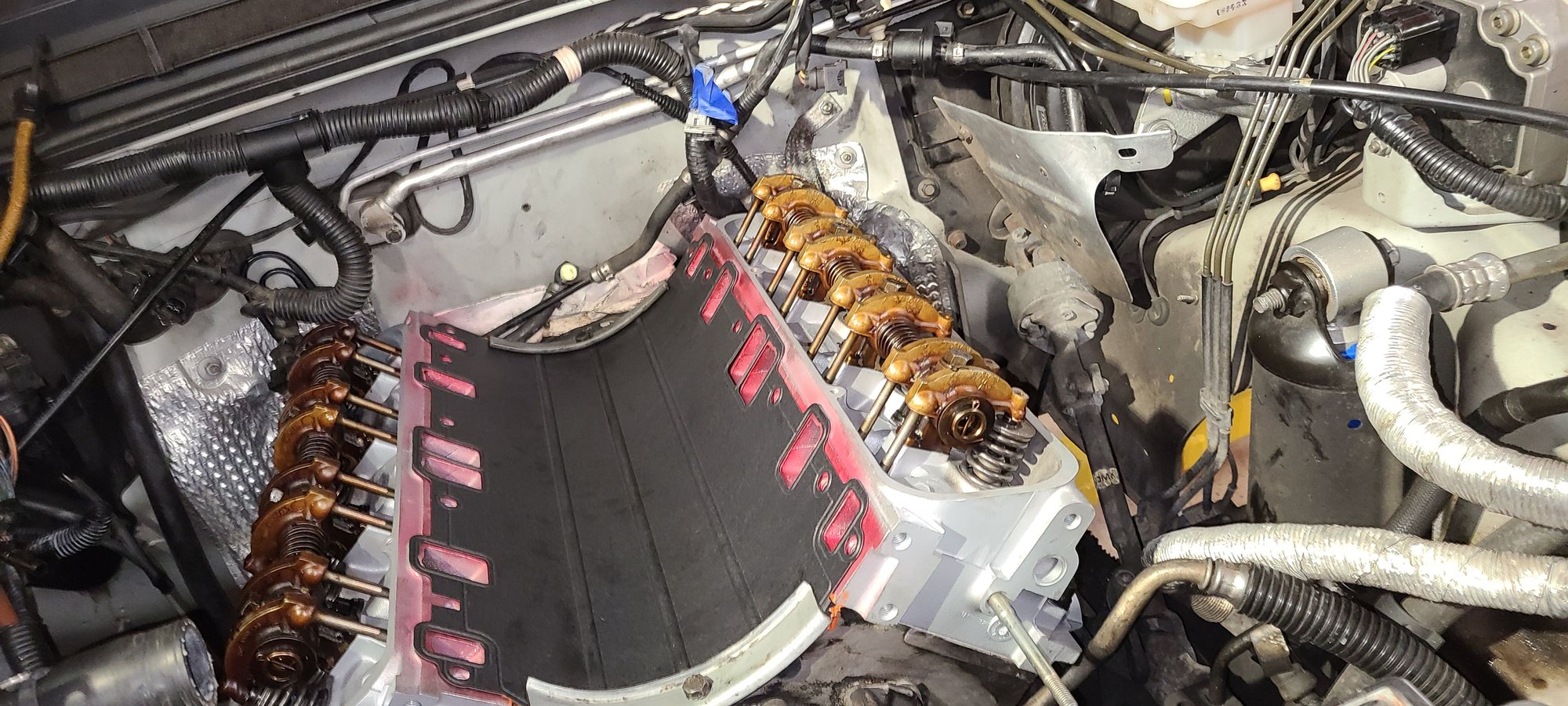

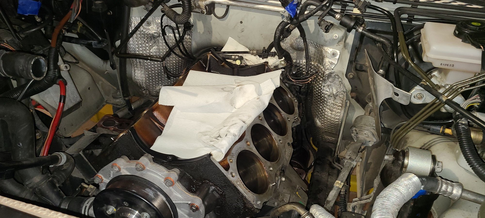

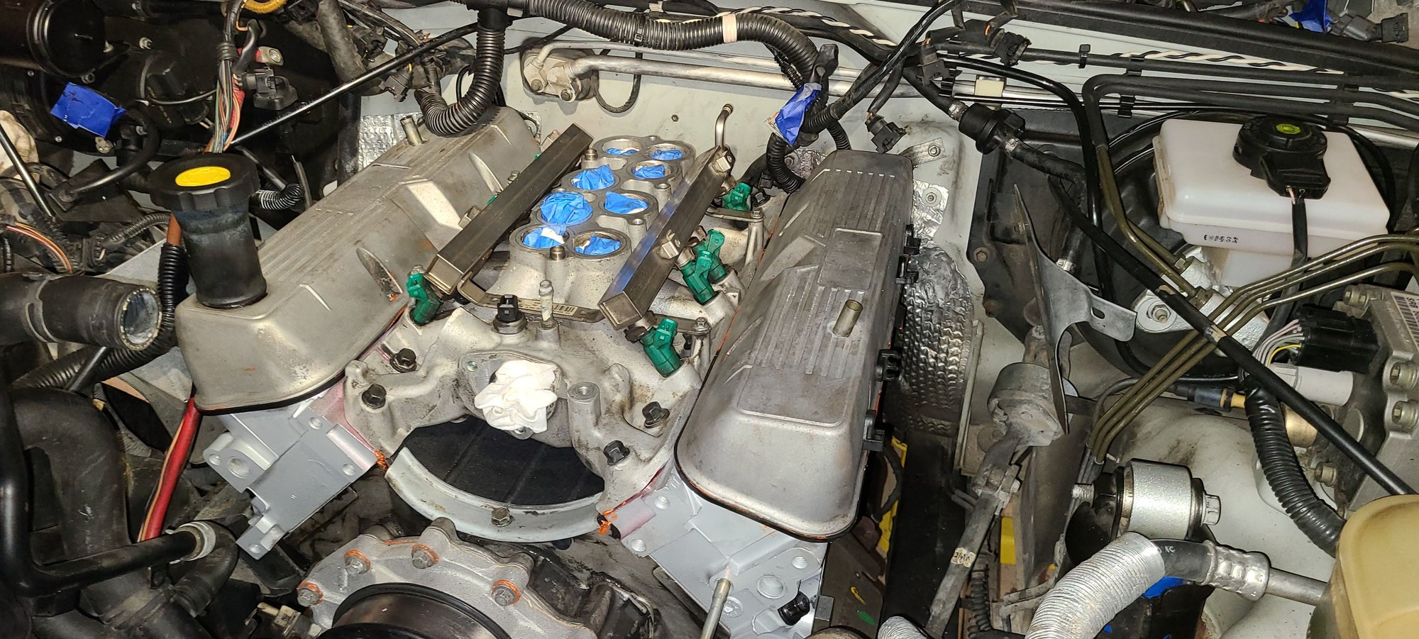

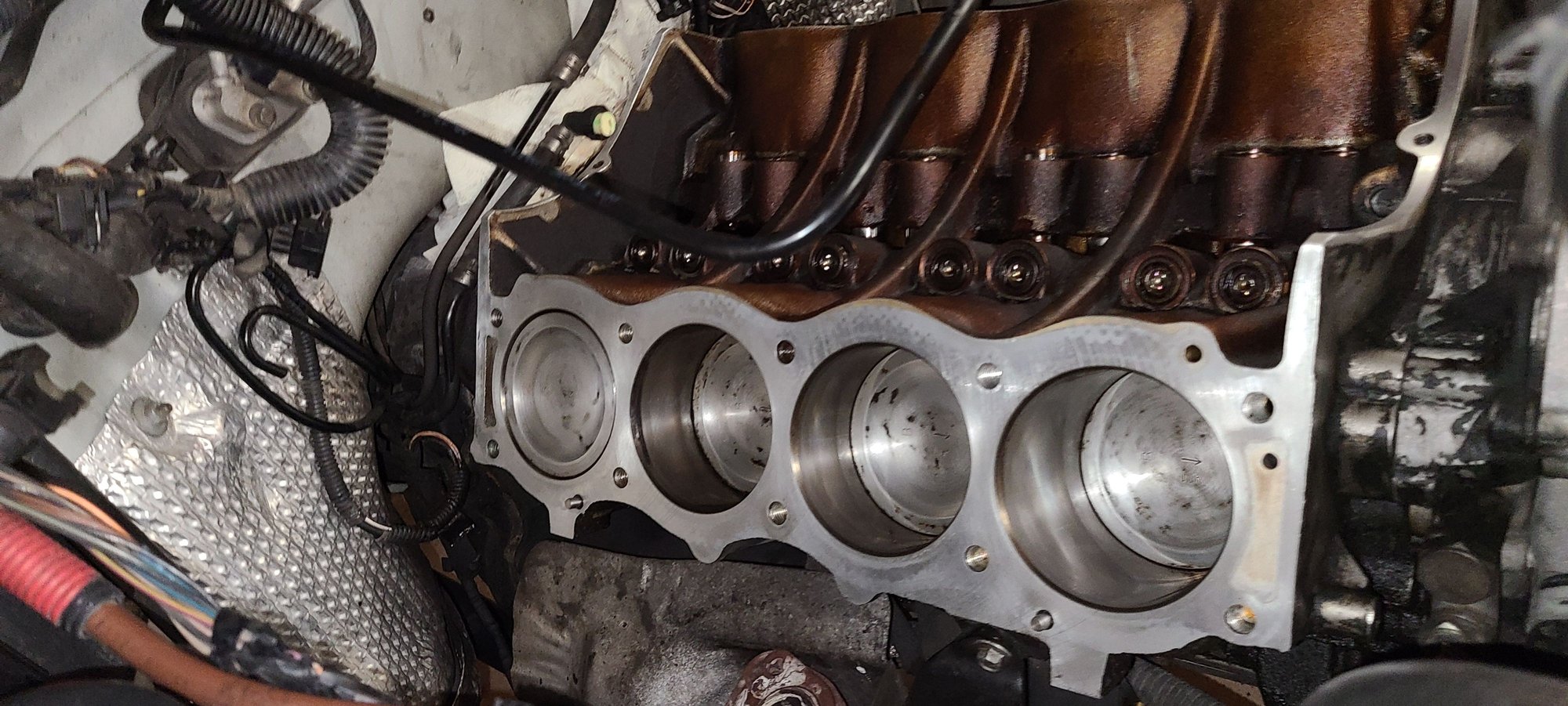

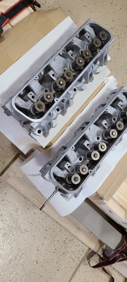

A quick update, been a few months.
Nigel decided that before the ACE conversion kits were back on the shelves to start leaking outside the block at the number 8 cylinder head. That kind of forced my hand.
I tore him down and resealed the engine, with a new set of victor reinz gaskets and ARP head studs, cylinders were in great shape and no slipped liners. had the heads completely rebuilt. Gained power and gas mileage across the power band.
a few photos
being torn down
rebuilt heads
ready to drive
