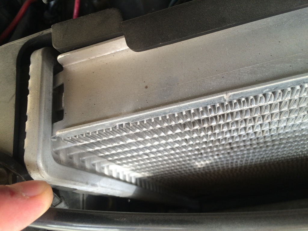

Heard a lot of speculation about the two, but at the end of the day I pulled the trigger on a $95 shipped Silla radiator from Genesis auto parts. I assume there's a difference and I'm wondering if this is it:

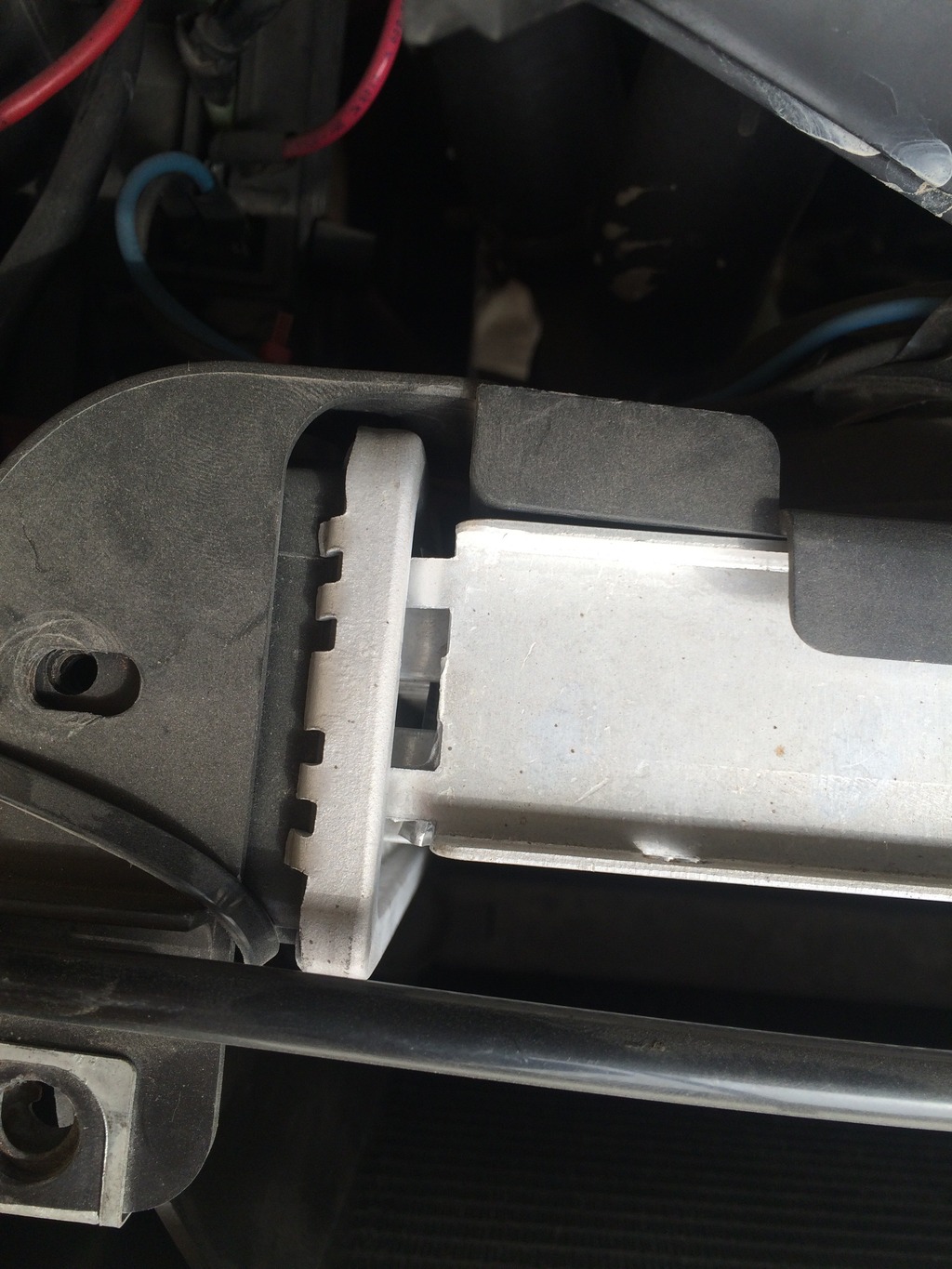

As you can see the body (1.5") is thinner than the side tanks (2.5"). I'm curious if in the Nissens the body is wider, allowing greater capacity and therefore better cooling. Can anyone pry the shroud off the top and take a picture of their Nissens?
My temps aren't where I'd like them...200ish with spikes up to 215 on the hwy going 75. Problem is it could be the:

I thought with the pics, this could be an easy one to eliminate or confirm.

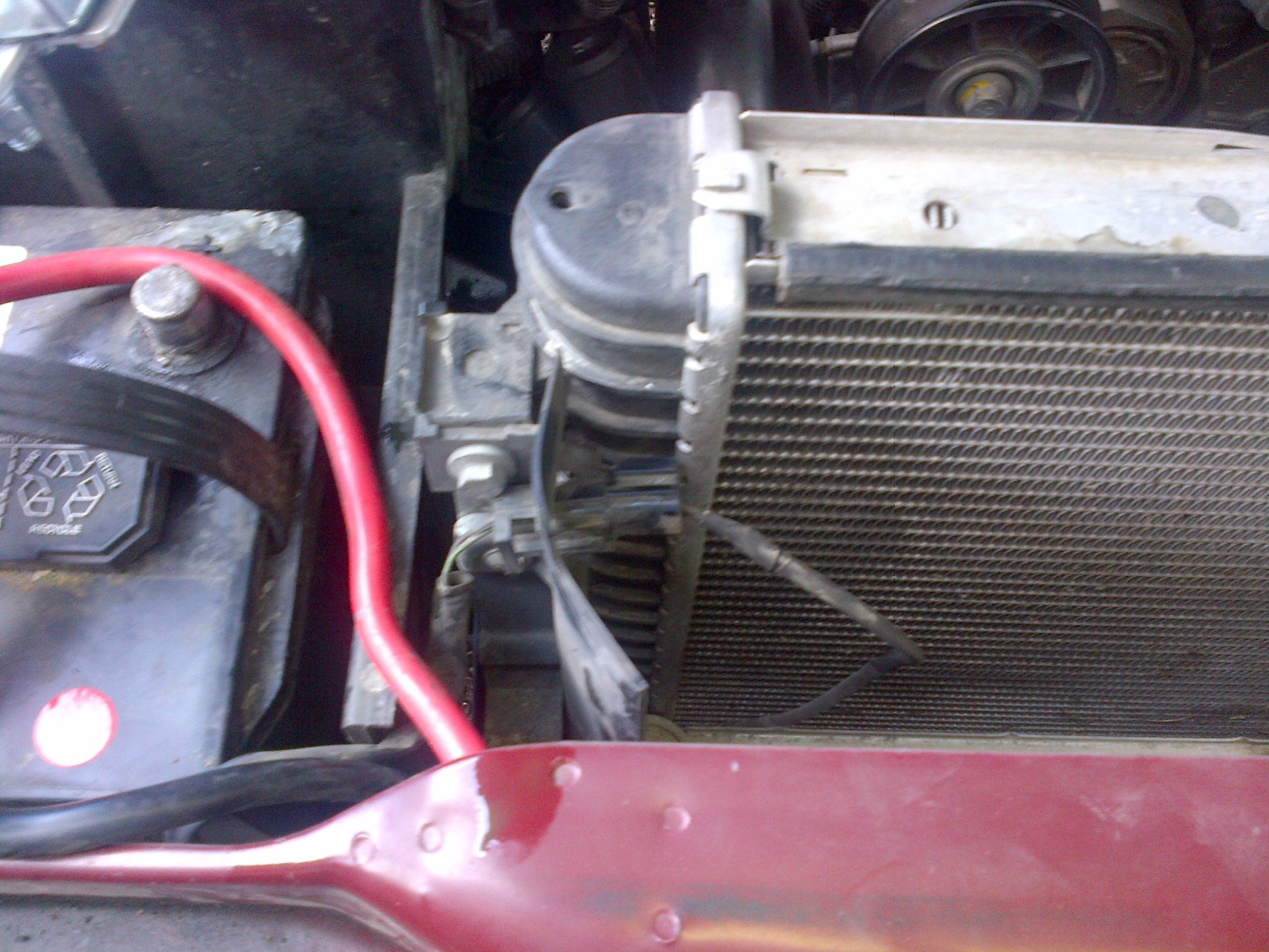

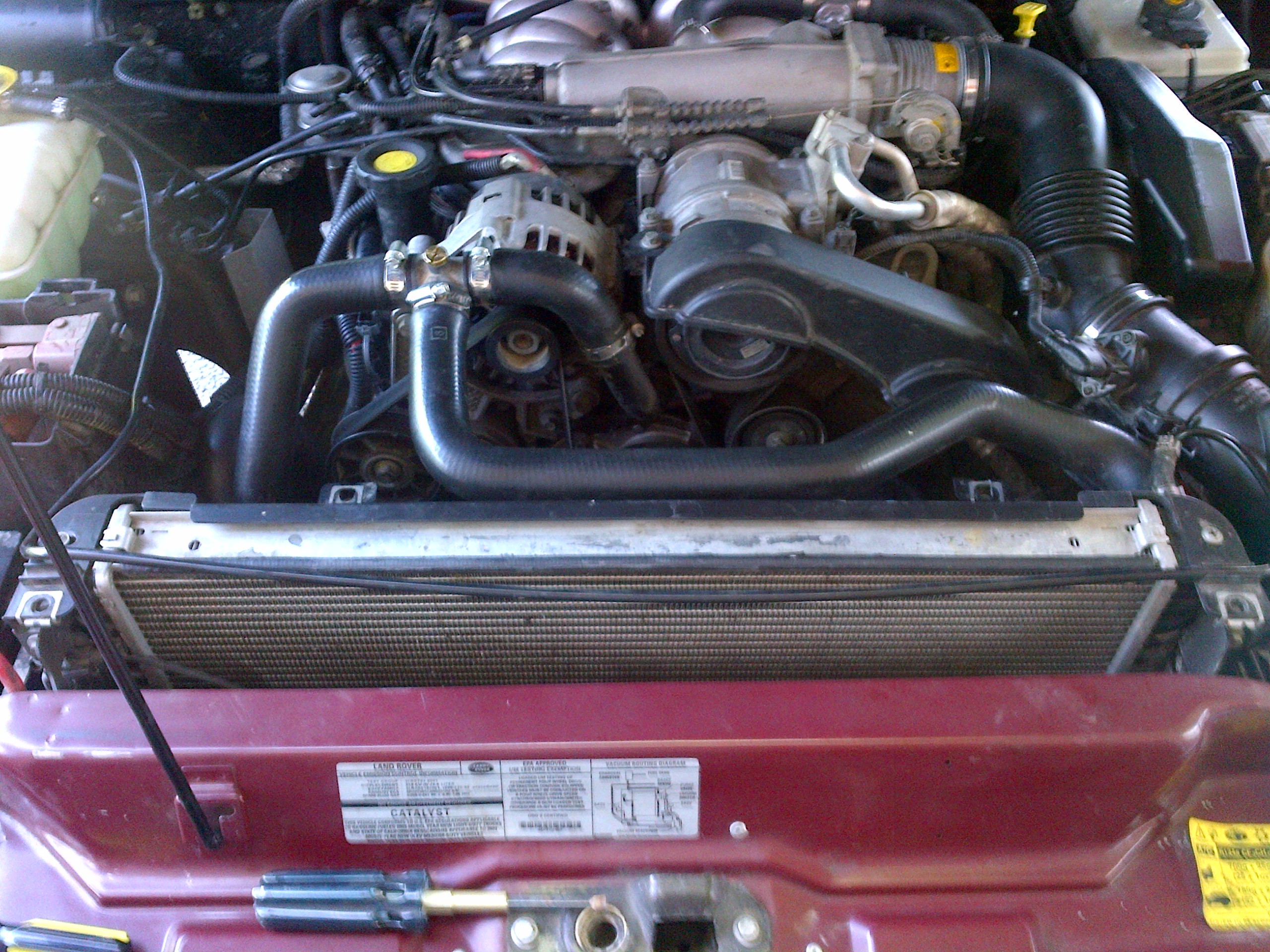

Looks a little thinner than the one on mine, but I don't know what brand I have.
It was on truck when I bought it , & it looked new, so I never bothered finding the brand, & my temp goes up & down between 185 & 197, depending on city or hwy,
(City - Ambiant +97* with traffic +AC 185 to 194) (Fwy Ambiant +97* 75mph +AC 190 to 196)
(ideling with AC on after 20min in +97* ambiant goes up & down every 40second 192-197)
That's with a aftermarket soft spring 172.5*black thermostat , with 190* thermostat it used to run 4-5 degree higher,
(4.6 motor)

Temps were read by my UG. If the new T-stat or H2O pump fix the problem, I'm still curious about the thickness of the Nissens by comparison. You really can't be too careful with the cooling system on this thing!
