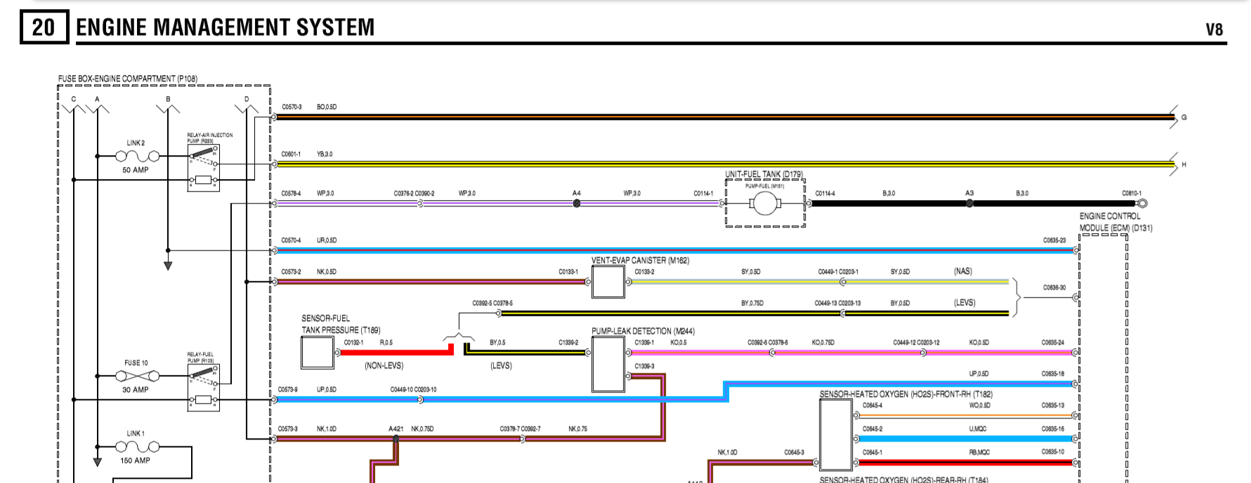

The power for the fuel pump comes right off fuse 10, to the relay, then straight to the fuel pump through the body harness. the only connection in line is right outside the fuel pump, and then at a splic A4 which is not located in RAVE
Are you getting power out of the relay? Is it activating? If it is, then you have a wire break somewhere along the line(if there truly is no power at the pump)
If the relay is not activating, it is either an ECM issue as it is the ground control for the relay activation, or an ignition switch issue
