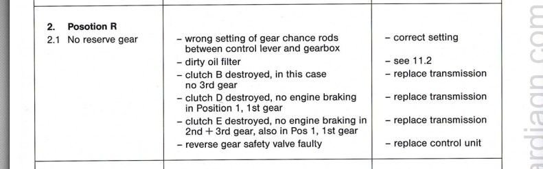

Hey I never answered you on the lights on the shifter and dash But they do coordinate with each other. It's just weird I'm thinking it may be the shift solenoids in the valve body But i'm not sure. And it'll probably run me a few hundred just to bring it somewhere that may not be that familiar with LR transmissions

I doubt it is the solenoids, they almost never go bad. More likely the reverse clutch is gone. Entire disassembly required. Few ZF trans rebuilders in the states but there are a few. Might want to consider swapping in replacement from a breaker given they rarely fail despite your personal issue.
