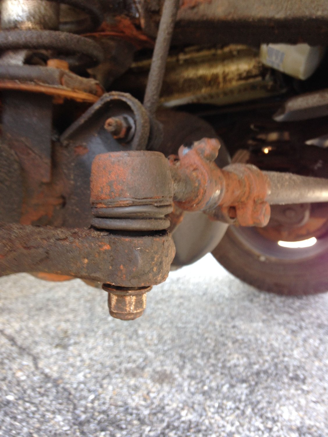

Movement in the drag link. I can cause a bit of a clunk (so some space) in the "taper joint"? The knuckle thing on the end where the draglink attaches to the steering knuckle.

Question of drag link, taper joint thing bolts… How do you get the nut off the end (or back on again for that matter once the bolt starts spinning freely?

Old Mar 9, 2016 | 02:02 PM

Okay, can't get a new tie rod end from autozone for less than 3 days...
Some panic is starting to set in.

Ah - there's a torx on the end of that bolt. Sometimes you just have to look at things from a different angle.
