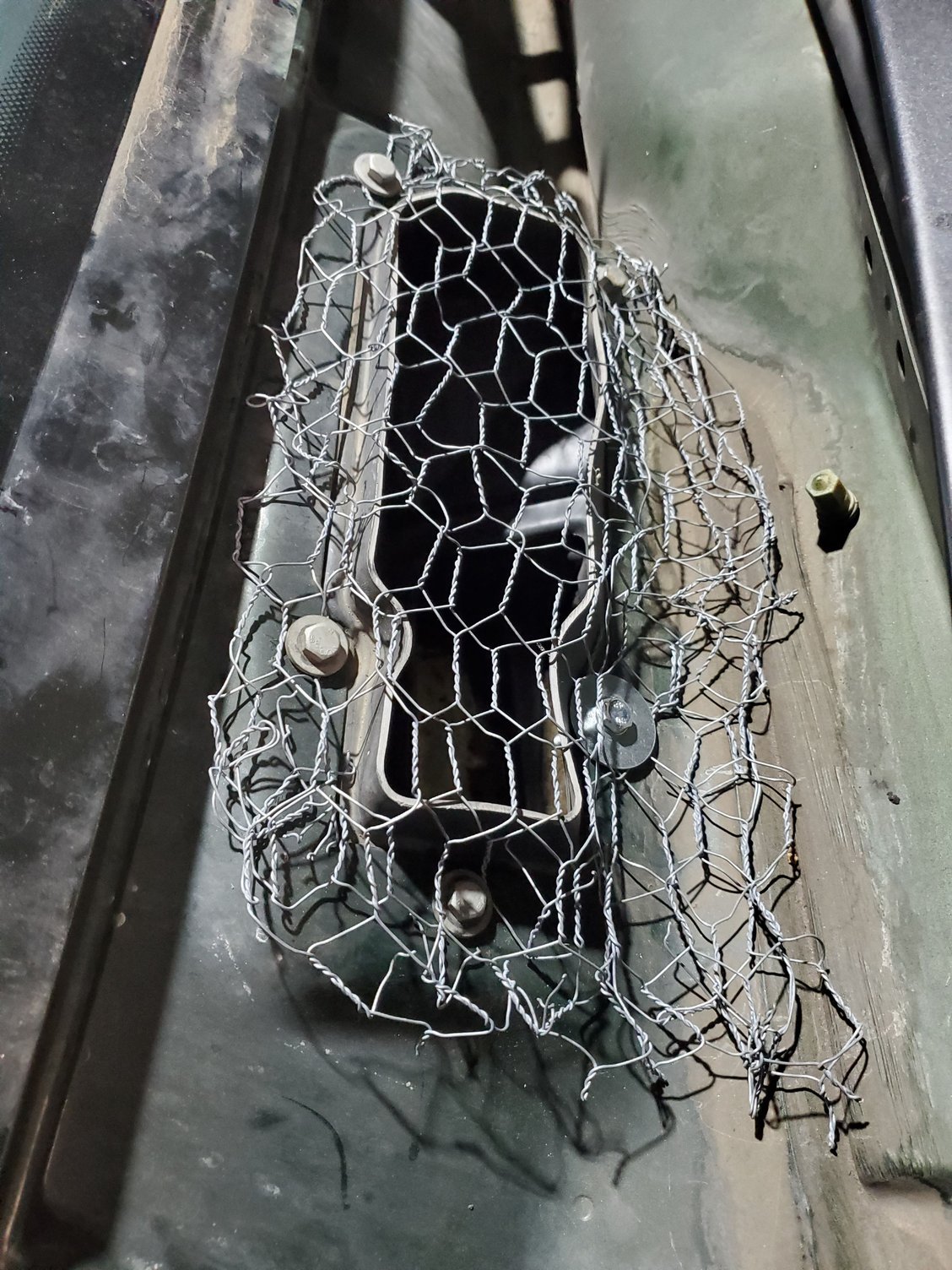

I had 16 acorns in my blower motor today. Question. Is how do they get there? I understand from the fresh air intake under the cowl. But how is a rodent getting under the cowl?
Any ideas on what I need to plug up?

Wide open under the cowl unless you place a screen over it.

It’s a pretty open path under the cowl…and rodents can squeeze through some disturbingly small holes.

I could not see how a rodent gets under the cowl, but I covered it up regardless. The bolts holding in the duct seemed made for holding down wire.

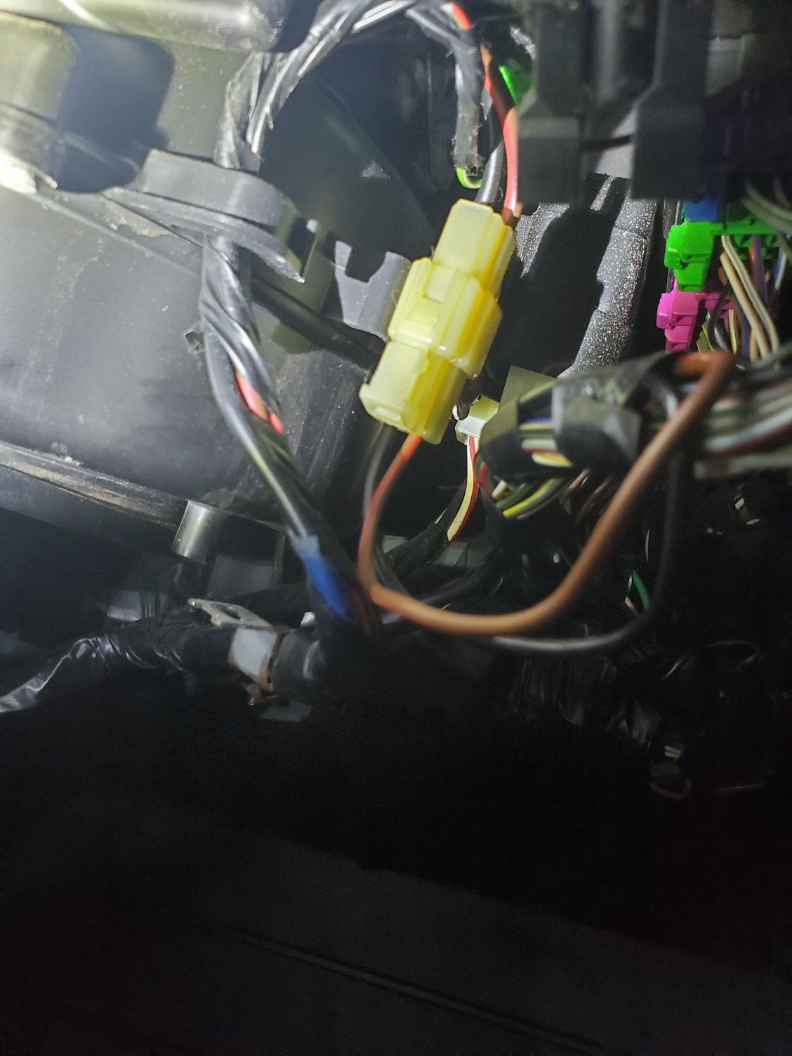

I put in a new blower, same symptoms. the motor will work if I jiggle the wiring under the dash, so I put it back together semi confident I found the issue. Once it was bolted in, there was no amount of manipulation of wiring that I could do that would get it to work again. I did notice that the wiring harness below with the larger gauge wiring was getting very hot. The red/black to brown/black connection. Does anyone know what that is? It appears to go into the the blower motor housing. Could that be the resistor pack? I thought when those failed, only high speed worked?
