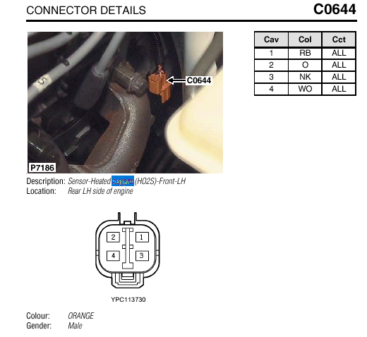

Ok so i finally got around to trying to fix the harness but i cant find in the rave what color pin goes where. So if anyone can help me out i would appreciate it.
Btw i know you cant really tell the color by the pic but i can by following the wires further up the harness.

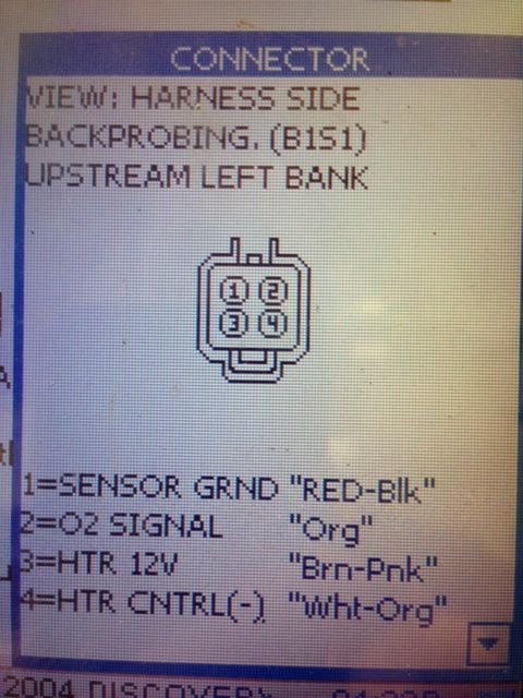

Wow! thats scary, all same colors or im color blind. I know how hard it is to get to those wires? Since you mentioned its not in RAVE, then you have to get to the other side and trace each pin again. Hopfully someone went that far for the pinout. Not sure if this picture can help you.
Old Feb 3, 2017 | 07:18 PM
LR03NJ's Avatar
Joined: Feb 2009
Posts: 2,186
Likes: 200
From: Linden, NJ
Here

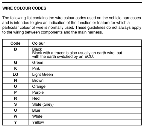

Thanks. Used the info you provided and been driving for a bit now with no issues. I had to trace the wires all the way up to the firewall behind the intake manifold just to see what color they were. Also routed the wire far away from the exhaust manifold that gave me the benefit of 1 being away from heat and 2 easier access from underneath.
C0645 FRONT RH
C0644 FRONT LH
