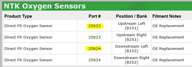

Another quality O2 sensor option is NTK
NTK O2's and NGK Spark Plugs are the only choice for me. They just perform like they should with zero issues....simple.
You can SEARCH the Ecat here > NGK Spark Plugs
