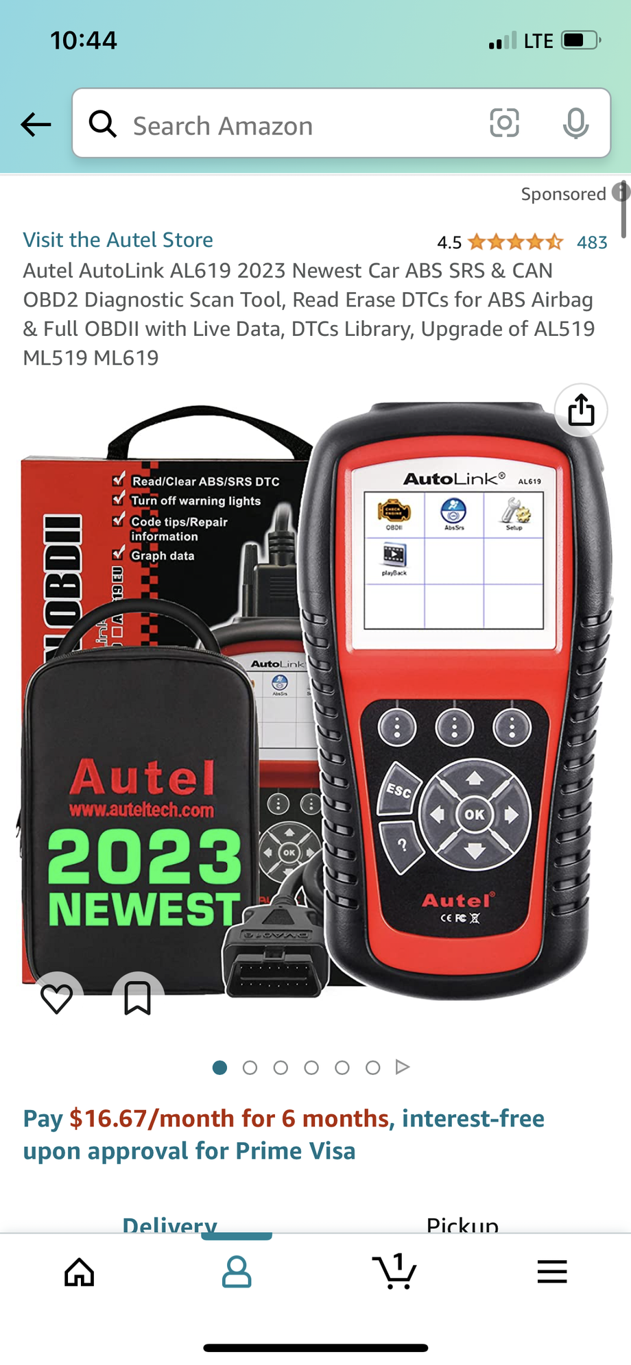

Live data especially with O2 sensors is extremely helpful when troubleshooting. This very inexpensive Autel 619 is a really, really good tool to have.
It’s unlikely that you have 3 bad sensors. I’d would get this scanner and see what your live data says and go from there. My last O2 issue was bank 1 sensor 1 holding at a constant voltage( they are supposed to fluctuate), this scanner was helpful tracking that down.

I have that Autel scanner, its a great value and I recommend it. On the plus side the downstream sensors have nothing to do with the actual running or health of the truck. It's just an emissions control indicator which causes the check engine light to illuminate if the ECU thinks the catalytic converters aren't working right. Now, I certainly understand the desire to not be driving around with the CEL on all the time and just have it fixed, because that's the kind of person I am. However, I will 100% admit to when I see the CEL come on I do a quick check with my ultragauge on the fly and if it's a downstream sensor issue I just clear it and don't think about it again until it turns on a month later.
All that being said, it certainly does sound like a wiring problem somewhere, but the exact code and live data are super useful to direct your further efforts.
