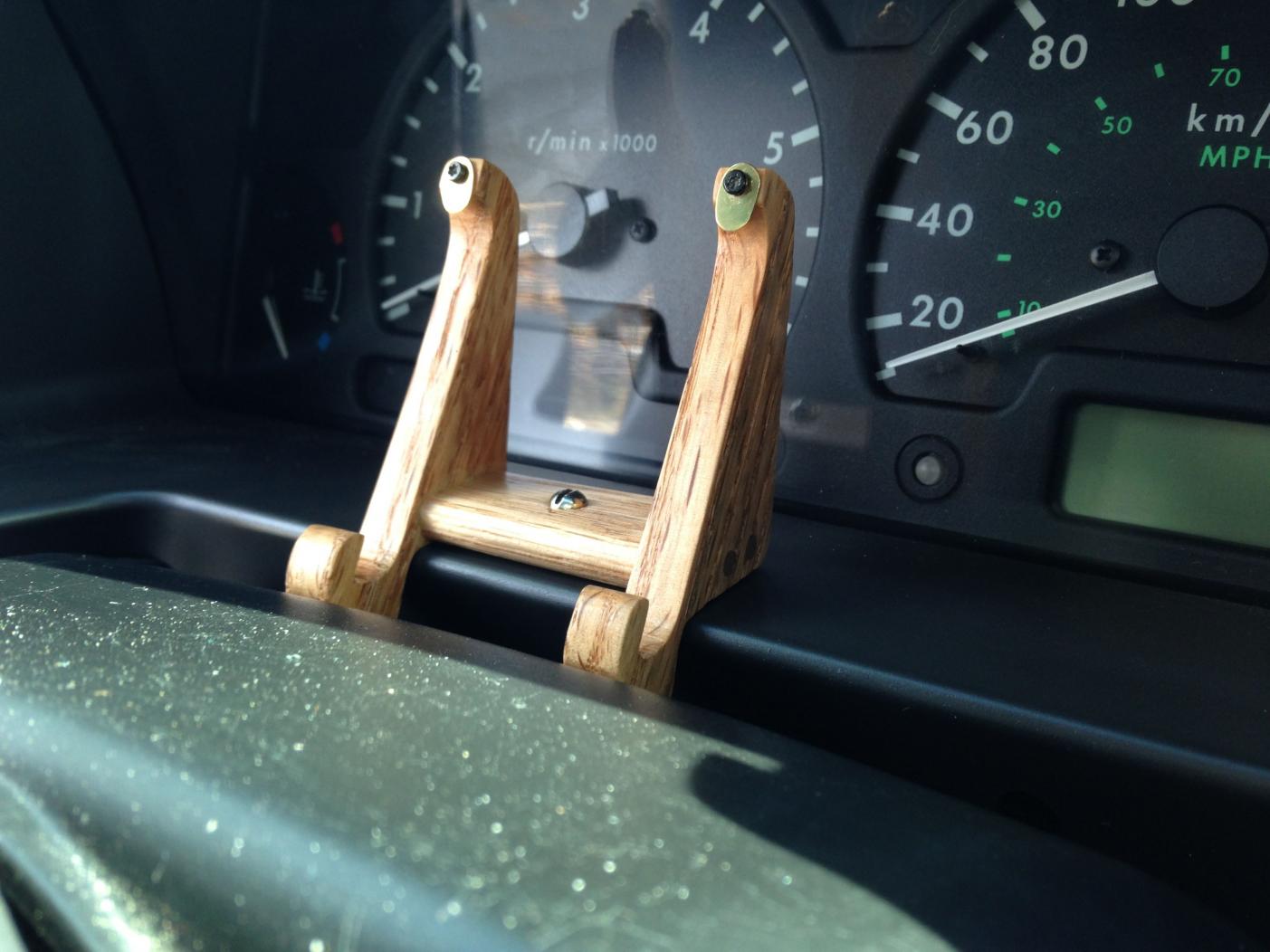

Attached Thumbnails OBD Bluetooth and an iPhone-img_1632.jpg   OBD Bluetooth and an iPhone-img_1636.jpg   OBD Bluetooth and an iPhone-img_1637.jpg
