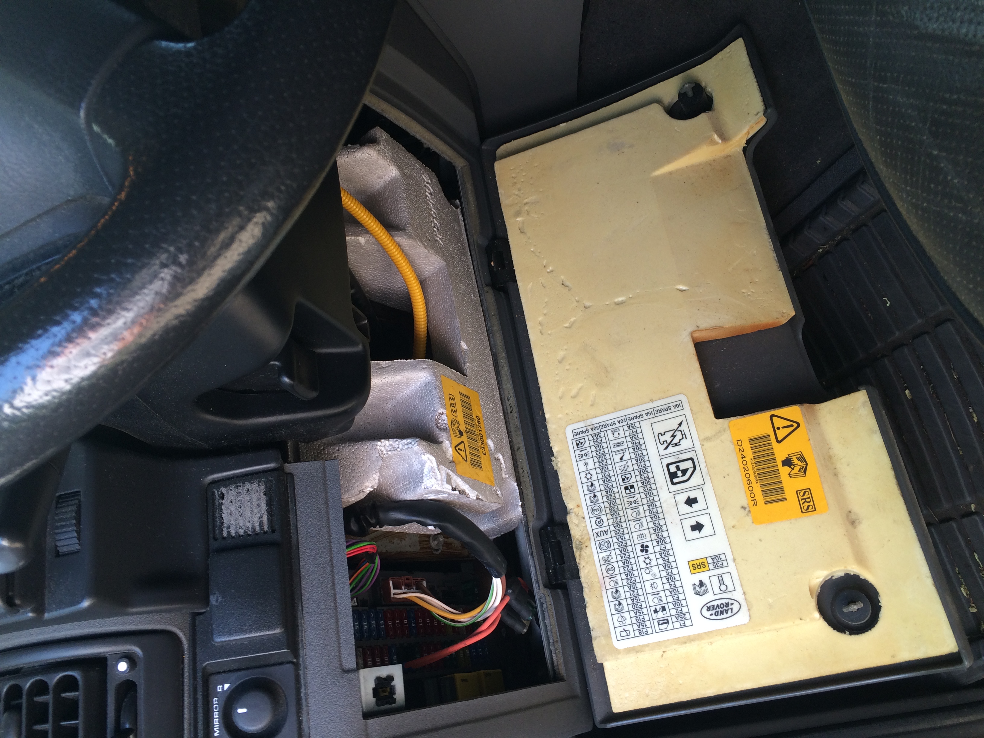

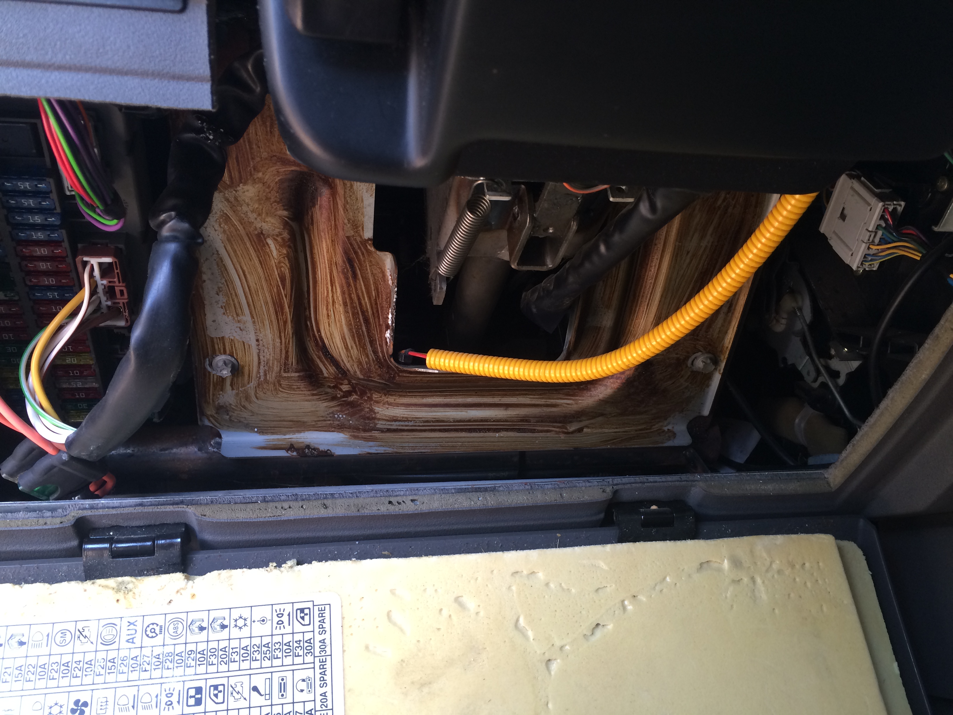

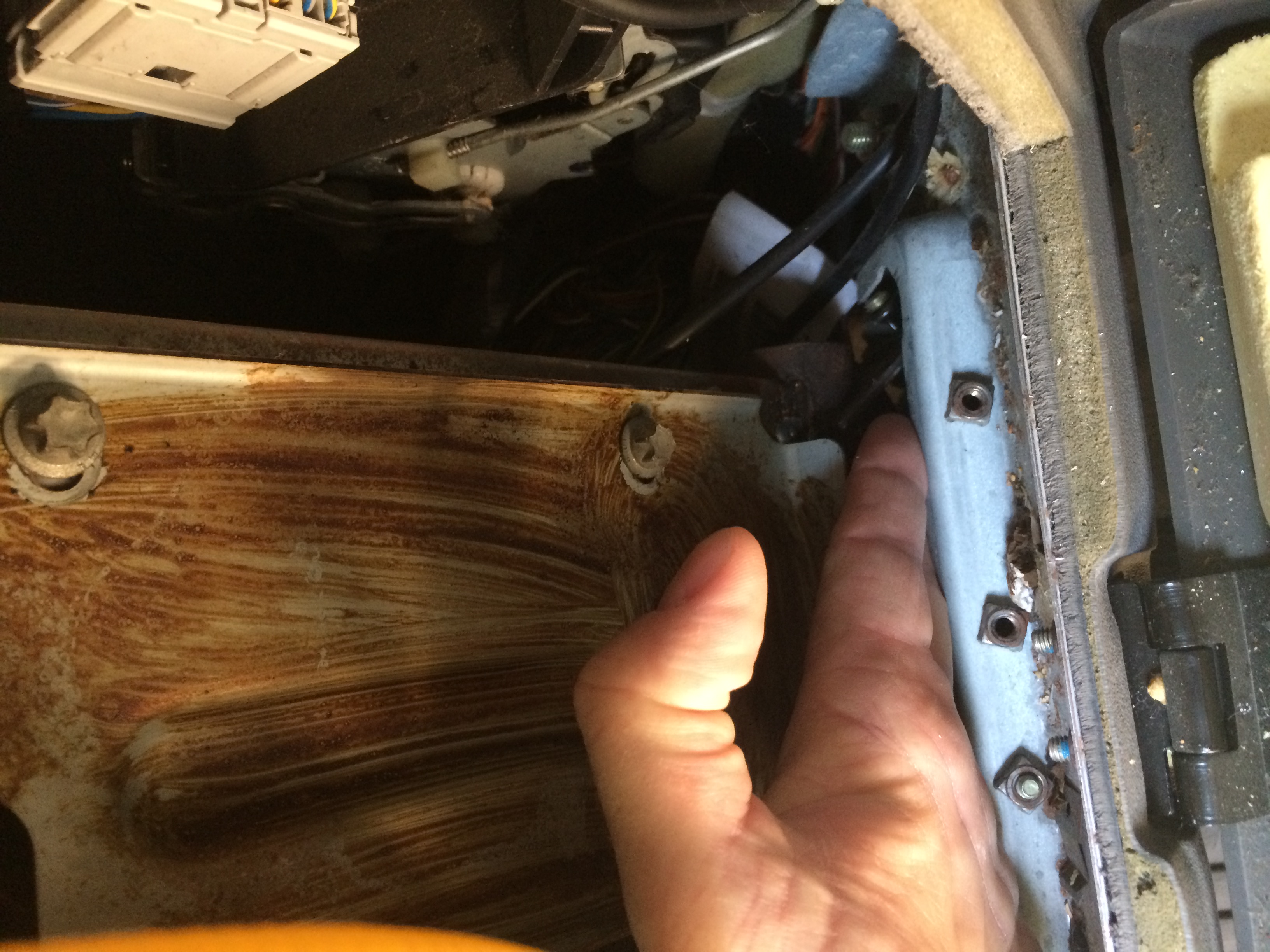

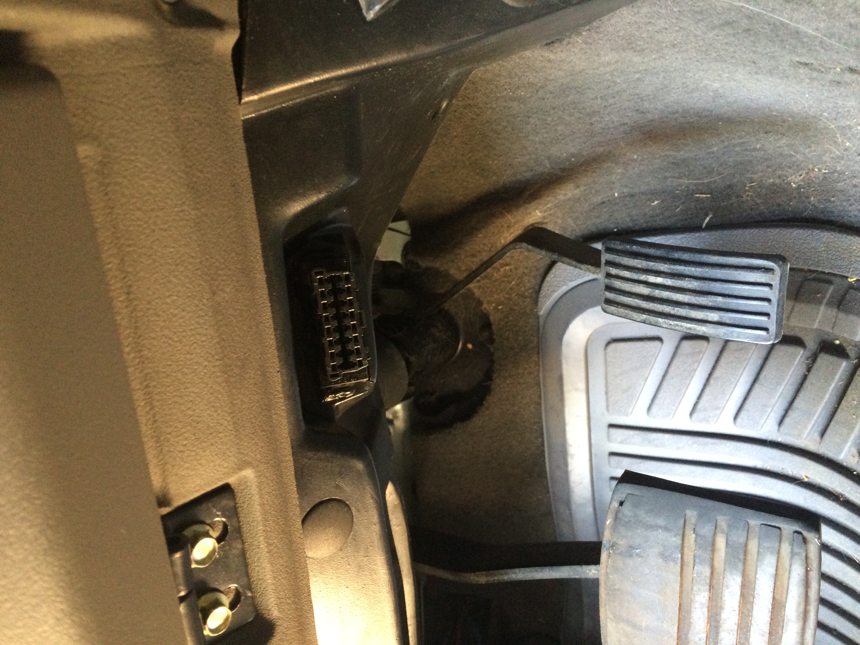

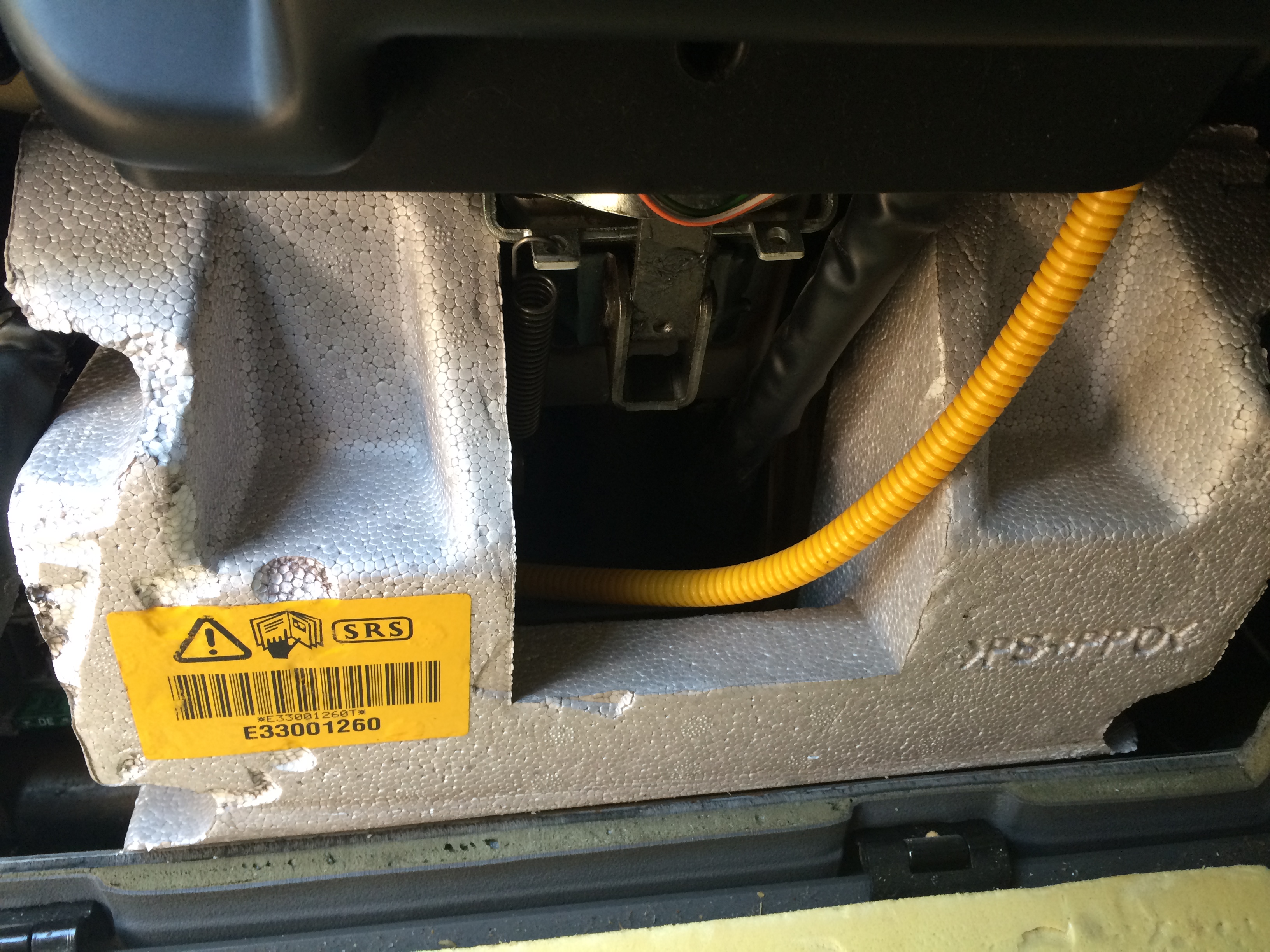

Here are pictures of what I'm trying to describe. In the last picture you can see that I'm squeezing my fingers in behind the OBDII connector and holding pressure on the back of the connector. Do that while connecting your code reader and then turn ignition to on and click on the code reader to connect. I hope that helps.
