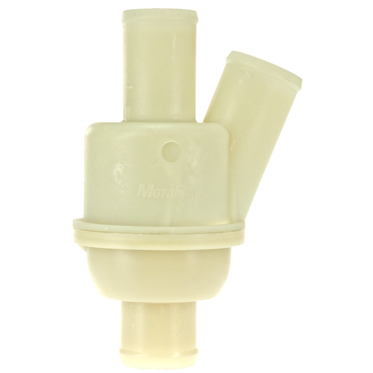

Why does this thermostat hack job work?

Does it restrict flow enough to still cool the coolant?

The D2 remote stat is a bypass stat. The top disk descends on the soft spring at idle, to allow just hot from engine coolant to enter the main chamber, out the slots at the bottom, into the double wall area, and out the "arm" to the water pump. So passengers get heat a little quicker. As main stat opens, it forces the disk back closed, and main water flow takes place. The disk also has a series of holes that always allow some "just heated" coolant to enter the main chamber, warming up the main stat so it will work. What a great design that those holes are at the bottom of a pipe run, so gunk can collect on them and change that metering flow....
By hacking out the innards, he has basically made it an open stat. Perhaps the cross section is just right in some conditions. Before members grabbed on to the 180F stat, the other work around was the in-line stat, where you used a conventional stat in a remote box, which still works great, probably better than the 180F soft spring, just more plumbing. Too cold an engine makes oil not perform as well, higher wear. Too hot and oil thins out, higher rate of wear. Fuel MPG adjusted by ECU based on engine temp, richer when colder. So too much gas, which will wash past rings into oil, and poor oil performance, and sludge happens.
