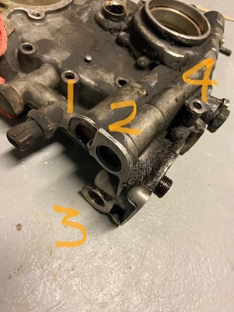

- You bypassed the front cover ports and went with the sandwich adapter because it was not compatible on the 04 cover. This seems to be debated. Some say it works fine through ports 3&4 in picture below. Im ok using either but wanted to know if it does work or not plumbed through ports 3 & 4.

Use the trans cooler if you can, there will not be a pressure drop issue and it will cool slightly better. I helped a forum member with his install, he had 04 and did not use the sandwich adapter, before the install we confirmed he had all the pressure relief bits in this front cover (he had purchased a used spare just in case).

Pls read the first post of my oil cooler thread again. The stock ports don't work because the bypass valve is always open, bypassing the oil cooler all the time. I also found out why the the bypass valve is always open, explained in another post in this thread. Either you have to make that valve working (get the missing parts) or simply install a sandwich, which is even better than tapping the stock ports because of an integrated thermostat.

Hi Discorama, yes read that, that's why I'm curious why some say it works fine. maybe some 04 covers have the valve and some do not. I like the adaptor with thermostat option and might just go with that. looks simple enough.
