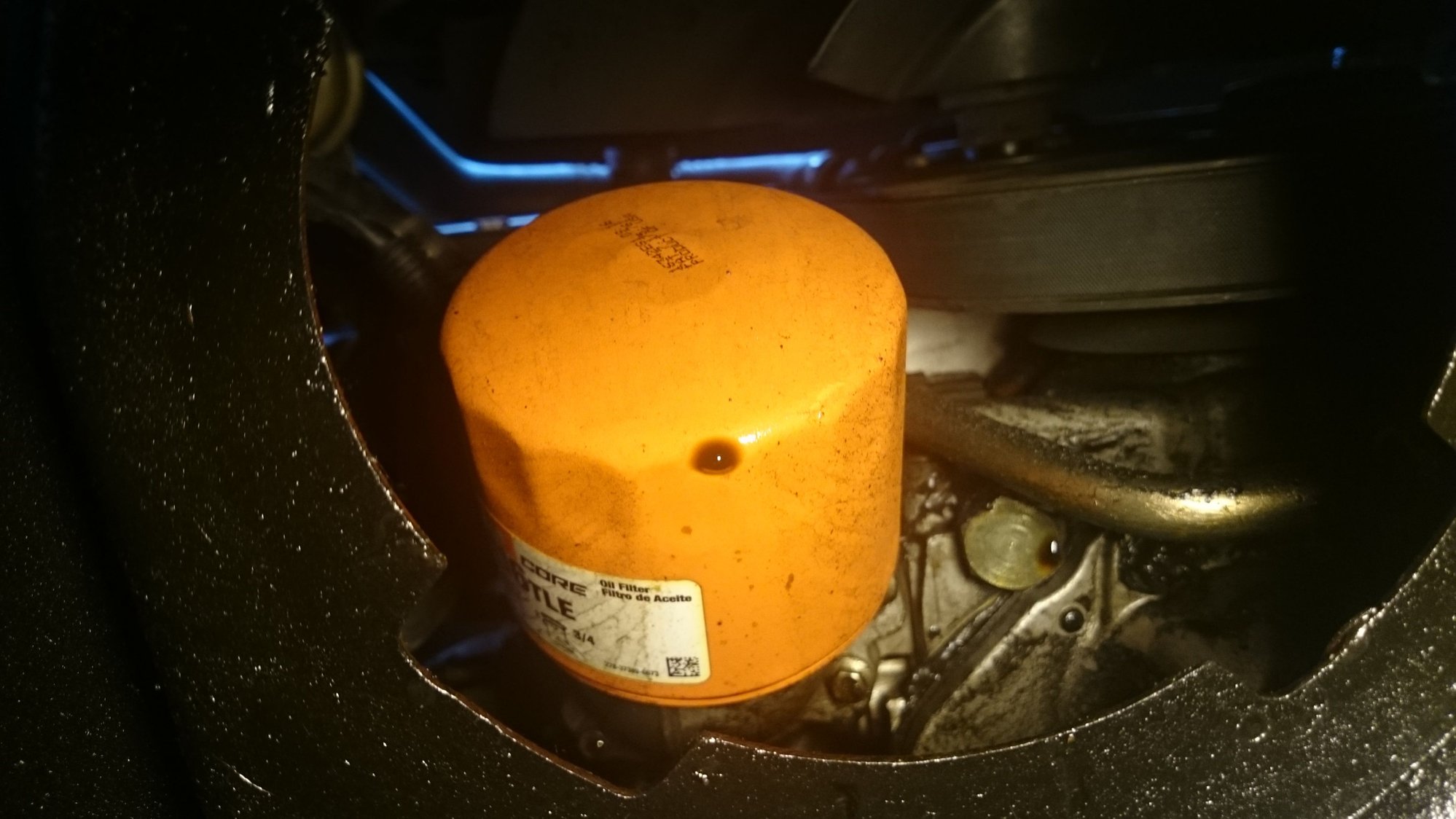

Hello! New in here, but hopefully can get some help! We recently got a 2004 D2 for the fam camping trips and turns out the now we have an oil leak (See attached picture). Any clues where is coming from?? Thanks!

First thing before I even waste typing a repeat reply from probably 50 other similar post. Spray it down with brake cleaner underneath it. Then wipe off any other fresh looking oil & let it idle. While it's running lay under it & look. Then turn it off and see if you can see where the drip is coming from. Then report back. Without that being done you are just wasting your time trying to locate it.
Going down the road can cause oil to blow all over the place making it impossible to pin point it's actual location.
Common Spots Oil Sending Unit 99-01 (unsure of your year as you have no info to your profile, or signature.....), Oil Cooler connections 99-02, Oil Cooler Line Blank Plugs 03-04, and front timing cover, front seal, valve covers, and rear seal.

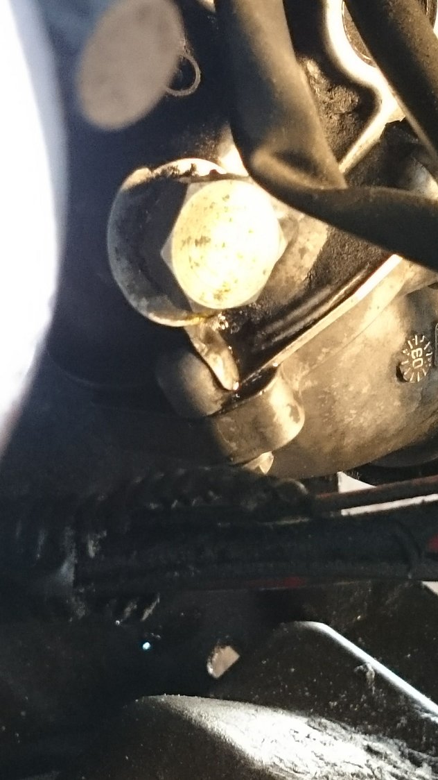

Since you have an 04 I'd remove the little plastic splash shield on the inside of the RF fender. It's held in place via 3 small phillips head/8mm screws. With that removed you should be able to see the side of your oil filter assembly. I'm willing to bet the 7/8 bolt/plug that is just above the filter is probably leaking. There is another one located behind the main crank pulley. Get a 7/8 open end wrench and with a little magic hand positioning you can see if it needs tightening up.
I'm working on my friends 03 D2 and after I changed the oil it left a decent little puddle after sitting over night. I removed the same panel, sprayed the area with brake clean and boom upon startup and shutdown I could see fresh oil oozing out of the 7/8 Oil Cooler Ling Plug. Tightened up and the leak went away.

So, I'm decided to find out from where the oil is coming, following the advises of best4x4. Although it will be a whole easier if I can remove the under-body splash shield, that seems some magic is needed to take it out in one piece, and being so new in the game, I don't know any. I hate the idea of the saw, as many recommended in the forum. Ideas????

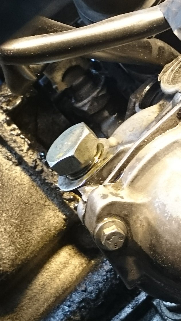

You were right sir! Bolt plug for the blank olive cooler is leaking!! Hopefully it is the only place. Oil leak!

Now with that dude leaking just like my friends 03 use a 7/8 open end wrench and you should be able to spot it from that side panel in the fender & feed your hand up thru the oil filter access hole & pull down.
I was able to get 2 1/2 good turns on my friends & boom problem solved. The splash shield does limit access, but it's kinda nice at keeping driveways clean & from keeping mud flying up into the engine bay while off roading. If it's not broken I say leave it. If it's cracked then just rip it out.
