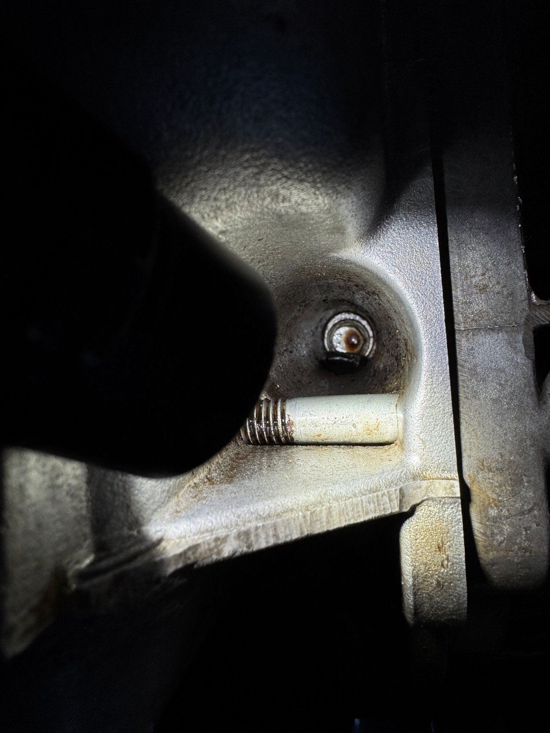

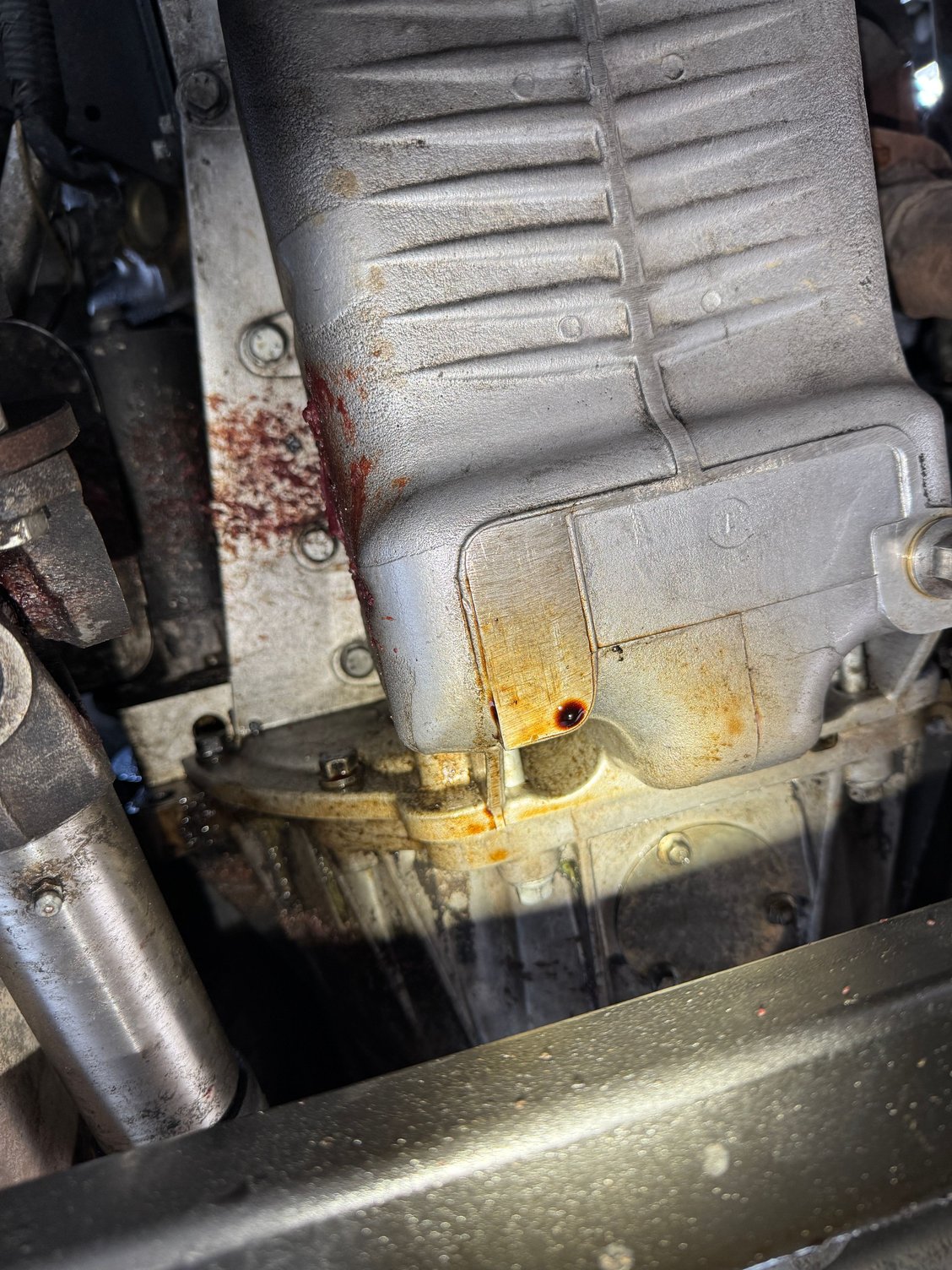

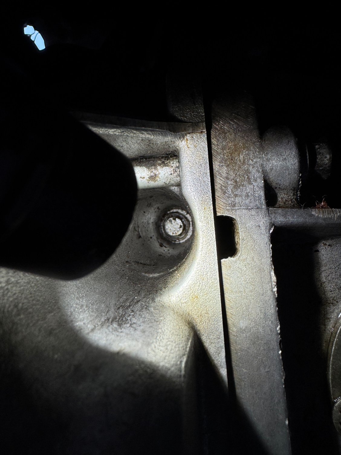

Engine is leak free EXCEPT these this leak from the two rear-most oil pan bolts that sit in those deep wells. I replaced the oil pan gasket a few years ago and check pan bolt torque every oil change. What's happening here? Did I somehow mess up the gasket installation?

Maybe try loosening the bolts that connect the oil pan to the transmission, then tightening those two bolts.

Omg I feel so stupid for not thinking to try that but I bet that’ll work. Thanks!
