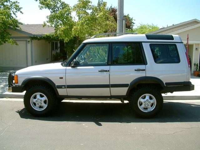

I know that Jon, E.E. will when possible, sell matched sets of coils. My front were installed by placing "A" on the drivers side and "B" on the passengers side.
As for the sagging, an old SLS issue that cab show up only on D2's.
Here is a picture of my truck with the SLS, it now sets apx. 1/4" lower in the rear without isolator rings but mounted on D1 coil mounts.
