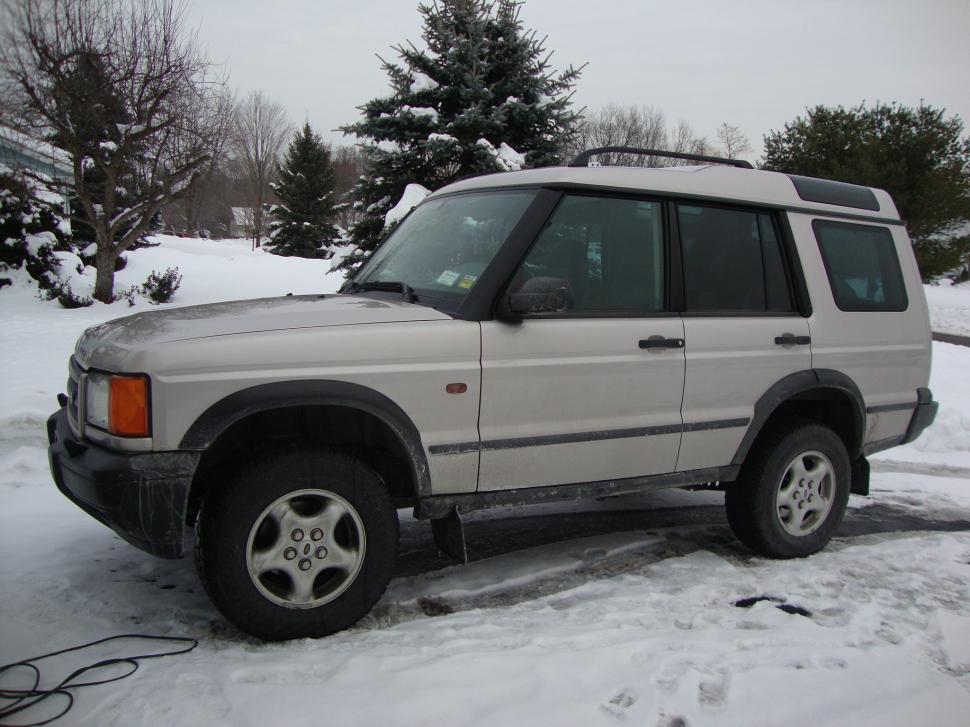

Anyone running an OME medium spring lift and stock size tires? If so can you post pictures please. I can get a really good deal on the lift but my bigger tires would have to wait so I just want to see what it would look like if I did the springs and ran the stock tires for a while.

That's what my setup is. It looks fine in my opinion, better than stock suspension with stock tires. I'll try to post a pic of mine tomorrow.

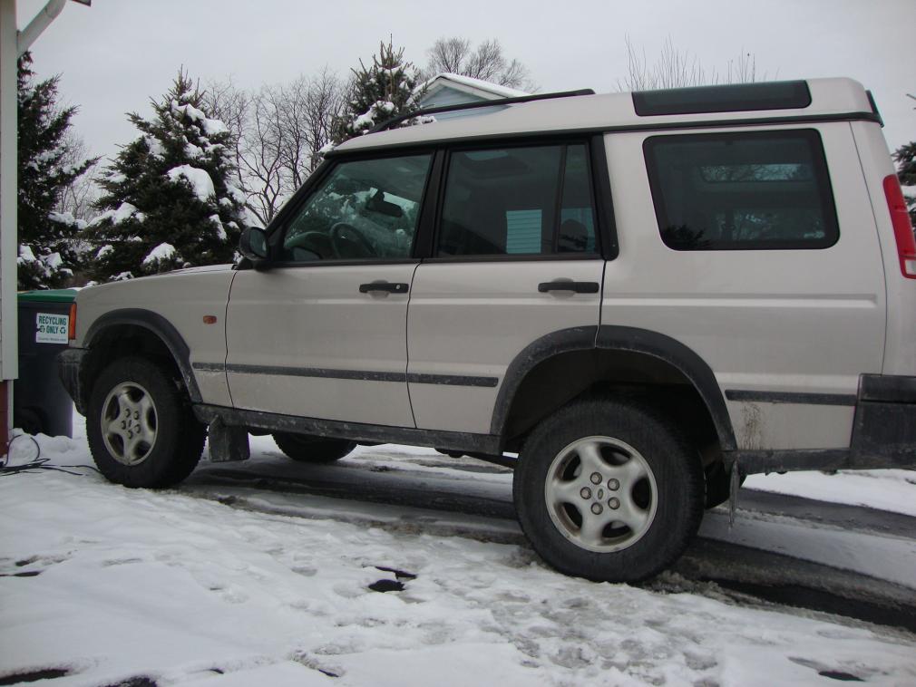

Ok, here you go. Stock size 16" tires with 2" OME lift - I'm pretty sure they're medium front and heavy rear springs, can't remember the part numbers.

Nice rig. You didn't have to change brake lines or mess with the driveshaft did you? I would think with a 2" lift you can get away without touching them.

Thanks, she's a bit dirty though. I installed the lift because I had a broken front spring (never would have seen it if weren't put on a lift during an inspection). So I decided to upgrade. Bigger tires will be next but these have a lot of tread left and I decided they are fine for now and what I do (plus they're dedicated winter/snow tires which is really what I want right now). A 2" lift is super easy to install, the new coils just swap in for the old one's. No messing with the brake lines or anything. You'll want to replace the rubber spring pads in the back, but that is it (and probably shocks too of course). I love how much higher you sit now, it actually feels like a truck again.

Thanks for the pictures. Do you have before and after height measurements? I've heard the OME medium springs are more of a 1.5" lift than a 2" lift.
