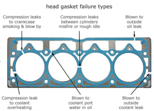

Old May 20, 2018 | 01:23 PM
No Doubt's Avatar
Joined: Jun 2017
Posts: 1,238
Likes: 240
From: Alabama + Vegas + Texas
Head gasket can leak in more than 2 places, too...
