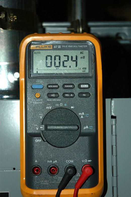

Originally Posted by DiscoIIBrandon
Am I right in assuming the heating element within the sensor tells the ECU when the truck is warmed up and then goes in closed loop?
They heat the O2 sensor to get it up to temperature ASAP so it can provide "normalized" readings to the ECU. You would think living in an exhaust gas stream would get it hot quick enough but apparently not.
The heating element is basically a resistor. Run power through it and it heats up. The two wires on the sensor with the same color are usually for the heating element. Heating elements don't care what "direction" the electricity flows through them.
The heating element does not report temperature back to the ECU.
Your ohm meter should have a "COM" position and an OHM position (looks like a horseshoe) for the leads. Then turn the selector to OHM (Horseshoe). There may be several ranges you can select. Picture attached.
You can test the sensors on the bench (out of the car).
