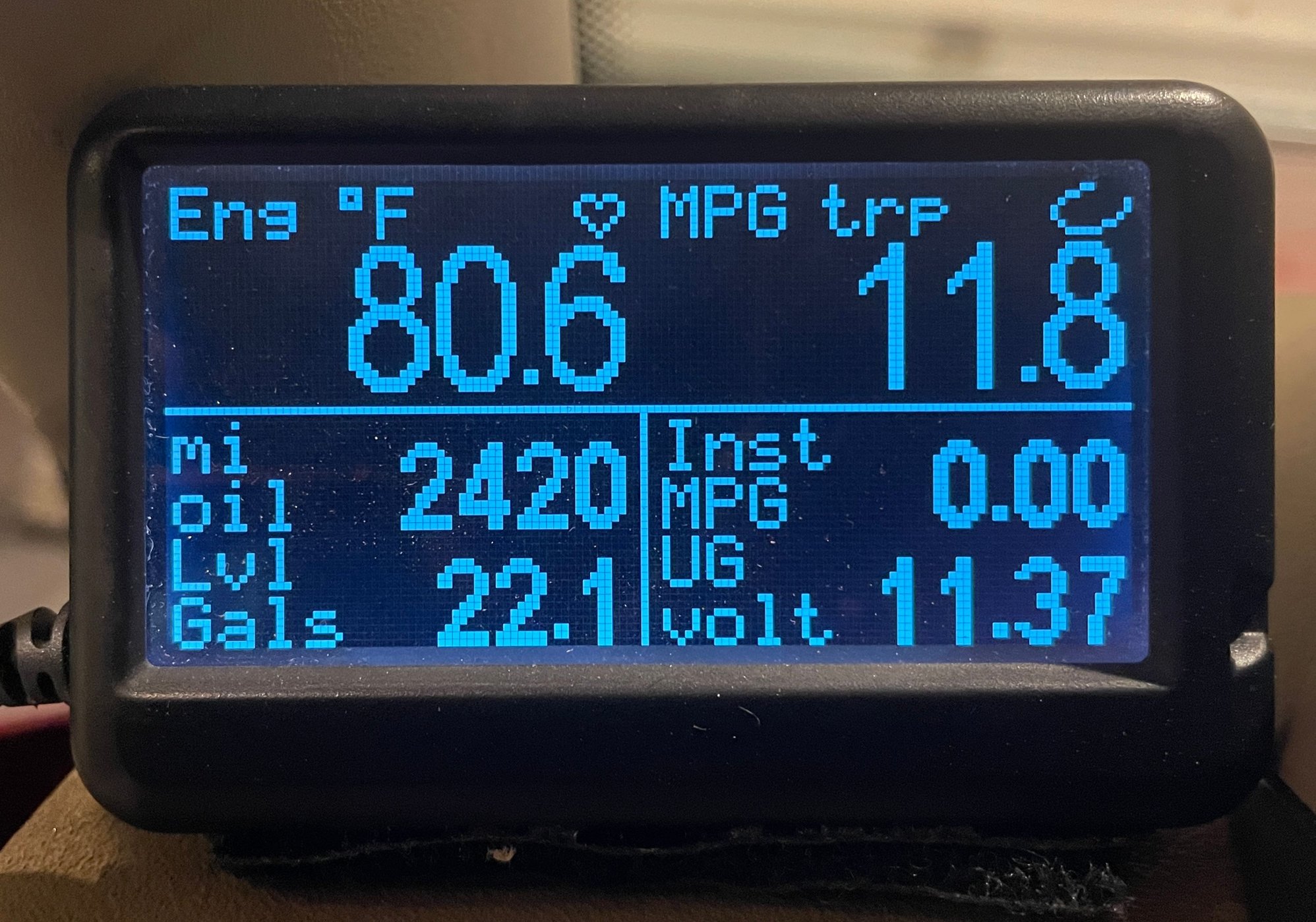

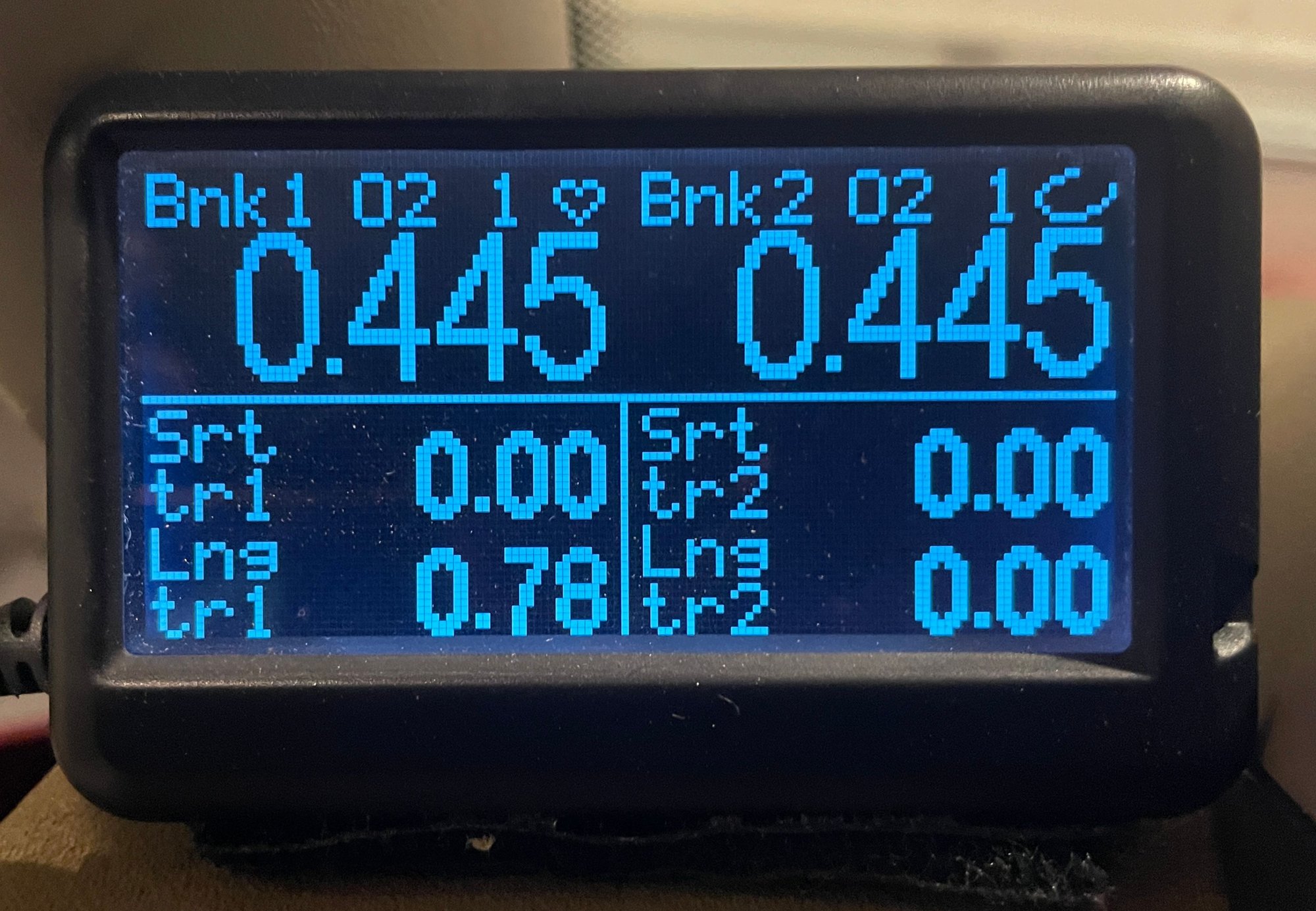

I have the UltraGauge in my truck set up with two pages that cycle every three seconds. One page is dedicated to monitoring the upstream sensor voltages and fuel trims. It's been quite a while since I've needed to replace a sensor, but the last time I was able to see one going bad before it triggered misfires and the SES light. Great peace of mind.

Yes, the B1S2 is the downstream driver's side sensor which shouldn't impact the fuel trim. Nice set-up with the UG screens.
