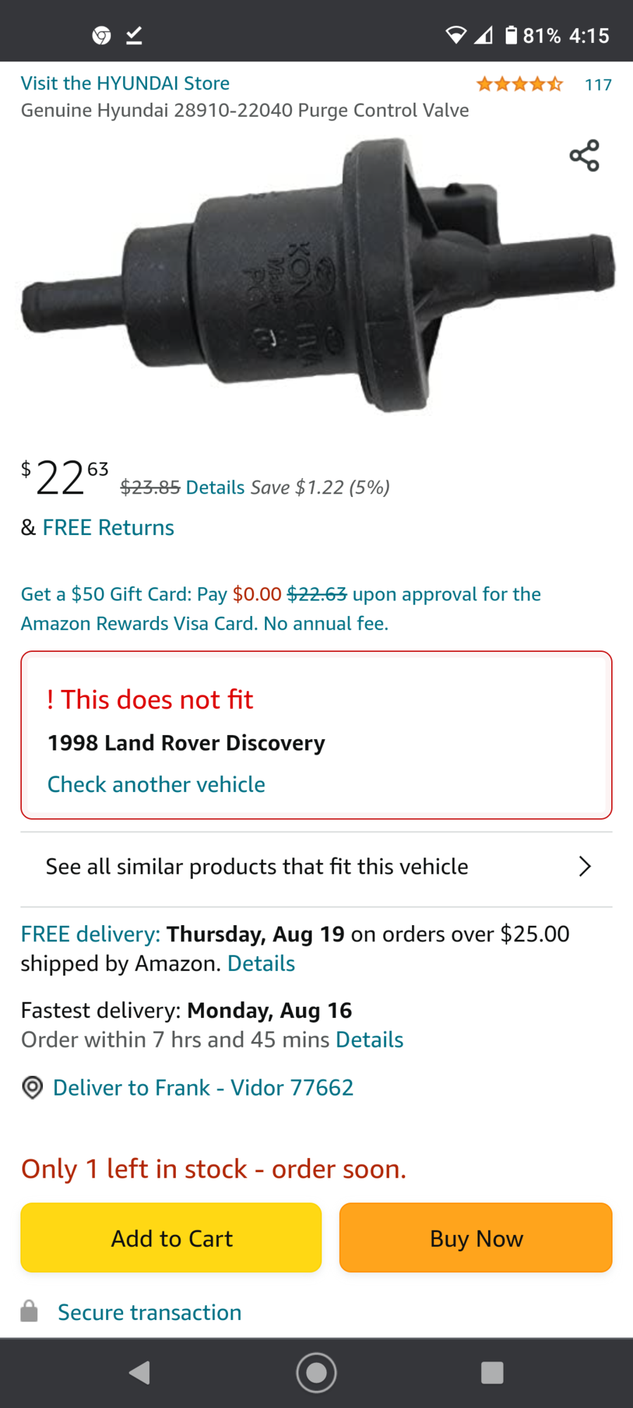

Purge Control Valve from Hyundai OEM Genuine

Most likely the purge valve. I got a genuine Bosch on ebay and it worked right out of the box. I tried a Hyundai before and didn't work for me.

Got it got it, yeah that’s the thing I mentioned I replaced in the original post that I couldn’t recall the name of. I guess that just leaves the gas cap?

You MUST get the OEM Hyundai unit in OEM packaging. Dorman, BWD, and other non OEM Purge Control Valves are pure crap. Either Bosch or OEM Hyundai = only way to go period. I have installed probably 100+ OEM Hyundai units without a single failure/issue.

I got an OEM Hyundai in the OEM packaging, yep!
