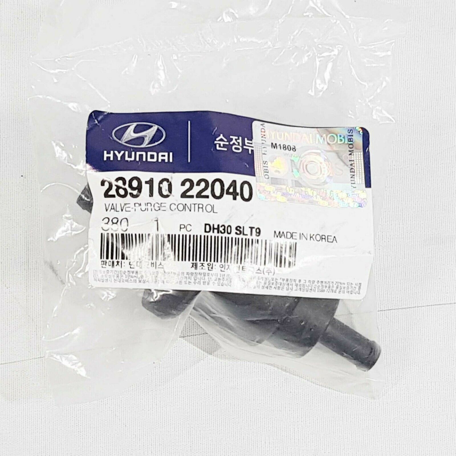

Was it a 100% Hyundai part in the OEM Hyundai packaging? I can't tell you how many of them I've installed with zero issues. With that being said I did notice a design change in the last one I bought vs the original Hyundai units I bought at first. I know for a fact the Dorman and no name Purge Control Valves are absolute garbage. Nothing against a Bosch Purge Control Valve especially since the price is normal now. It used to be the entire assembly for $$$. I've even got a D1 running the Hyundai purge control valve vs it's valve you can no longer purchase. Glad you got it taken care of though!

It was in a generic packaging labeled "OTUYAUTO ... made in P.R.C.".

Yeah that makes sense, the generic's are awful. I only use OEM Hyundai packaged units like this
Zero issues with the unit above, but I have seen plenty of the generic auto part store Dorman/ISUMO units fail for sure. It's been a while since I bought one, but the last time I got an OEM Hyundai unit out of CA for like 15.00 shipped online.

I was looking for a generic Hyundai. A Bosch generic was much easier to find. Paying $15 more is not a problem, gas is almost $5/gal in some places here.

Over the last weekend, I cleaned the idle control valve and replaced the purge valve with the OEM Hyundai unit. I will say with two days of use it idles much better now and no codes. The idle control valve was really dirty. I kept the Bosch purge valve in case I get error codes with the Hyundai unit.

Many years ago I had an 02 D2 and it ran great, but every once in a while either under load or at idle (mostly happened at idle) the engine would be running fine then nearly go down to 400RPM oil light would flash and then it would wake back up and be fine for the rest of the trip. Never set a fault but continued to do it regardless of being hot/cold. Well it came back in to me & I already knew it's history. Took a drive and bingo it did it right up the street. I brought it back and let it just sit at idle for a good bit hoping for a code to trip or be pending. To my surprise I came out and it had actually quit!!! Only code was a pending P0441. Checked the Bosch unit and it clicked when running, but it apparently would seize up and cause all sorts of trouble. Swapped it with a spare Bosch I had laying around as a test unit and told em to drive it for a few days and let me know. Customer called a week later and said THANK YOU THANK YOU!!! Whatever you did she's running flawless. I had em come back and let me install a brand new Hyundai unit, and that D2 never had that issue again. I took their original and stuck it into another D2 I was working on and the problem followed the Purge Control Valve. Dunno what it's problem was but it's been the only one I've ever seen do that!
