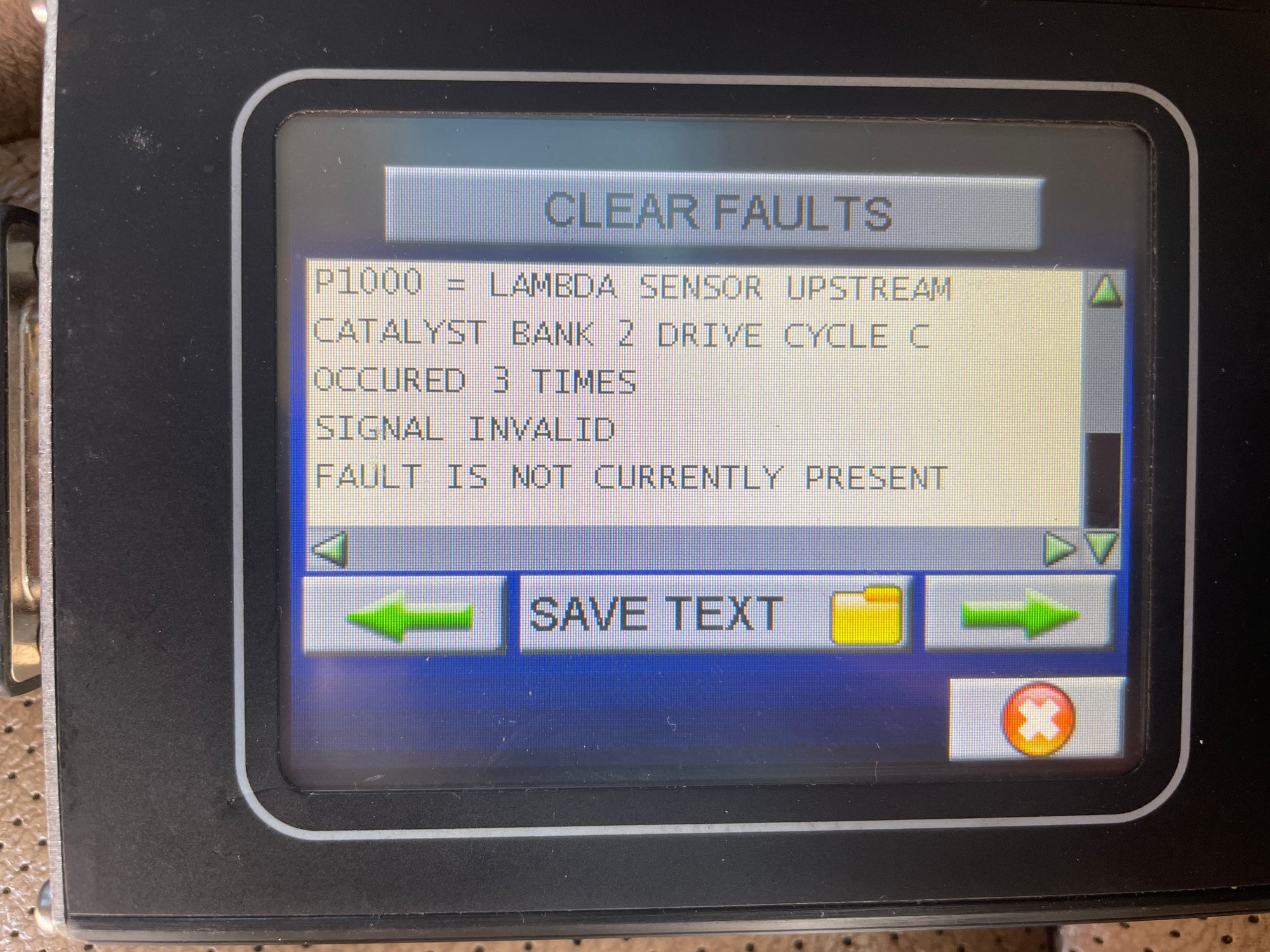

P1000 - Nanocom says upstream sensors have an issue, but they're new
Old Sep 4, 2021 | 12:51 PM
Brandon318's Avatar
Joined: Apr 2019
Posts: 2,046
Likes: 608
From: Monterey, CA
Default P1000 - Nanocom says upstream sensors have an issue, but they're new
I had a code back in the early summer that said the upstream sensors were struggling, so I replaced with new Bosch sensors and today this popped up. There's no way the Bosch sensors are already bad or were DOA? Also... might as well ask the dumb question... upstream is the bank of sensors closest to the engine, yes?
Yes. Sounds like it's time to chase wiring, maybe some vermit got to it and it shorts out occasionally.
*fault is not currently present*

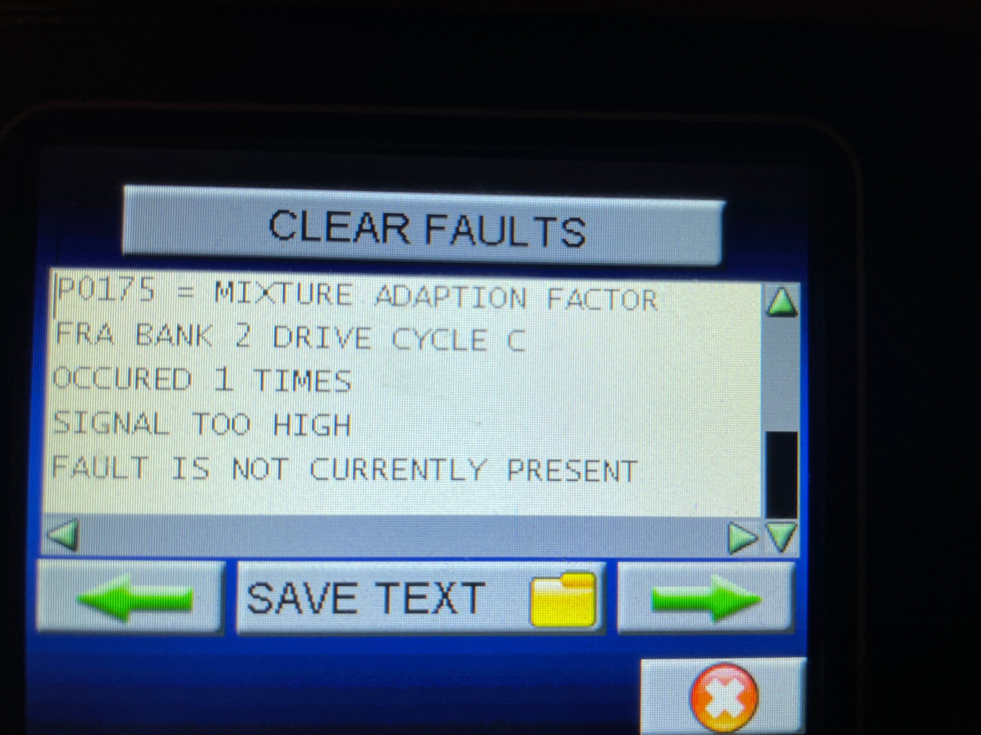

New, additional code thrown tonight and the P1000 language changed to 'signal missing'
