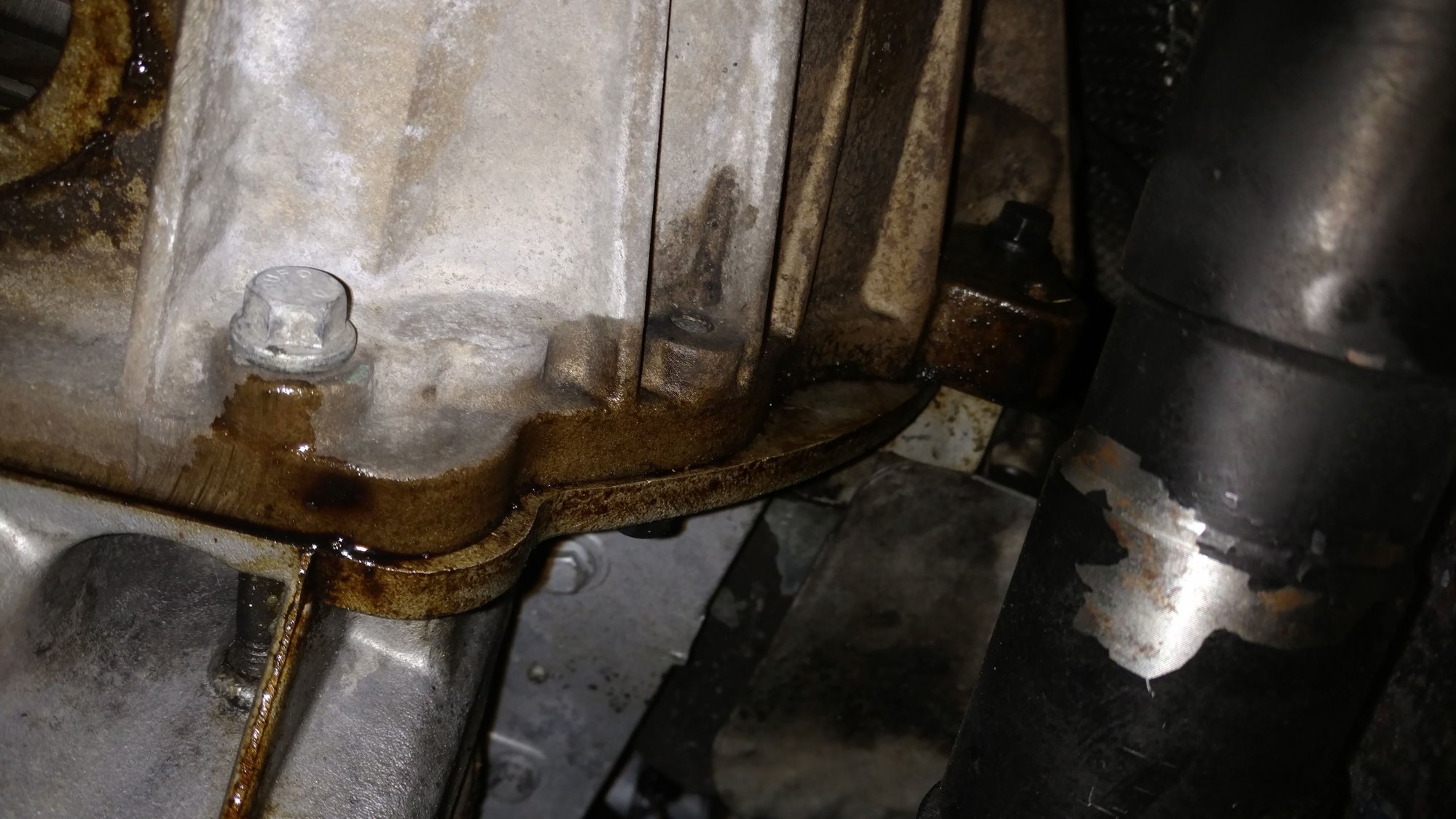

Next up new oil leak
Oil between motor and transmission

Pic 2 - Looks like it is running down the pass side of the block so I would check the valve cover gaskets. May need to simply tighten the bolts, mine were pretty loose when I bought the truck.

Removed inspection plate seemed dry up there. I don't really know what I'm looking at but I figured a bad rear main would splatter oil all over in there. Second pic shows a leak originating higher up. Could that work it's way behind the inspection plate?

Valve covers. Rear main is pretty solid in these engines. The front seal is a different story. If your oil pan is coated in oil, it's most likely the front seal. It looks like your valve covers are leaking by the looks of your pics.
You can change those gaskets twice a week and they'll still leak, it's just the Land Rover DNA. They leaked new at the dealers, no joke.

1500 miles on new motor. I've heard the valve covers can work loose so ili' check that they are all tight.
