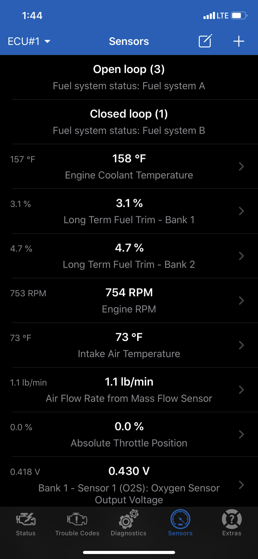

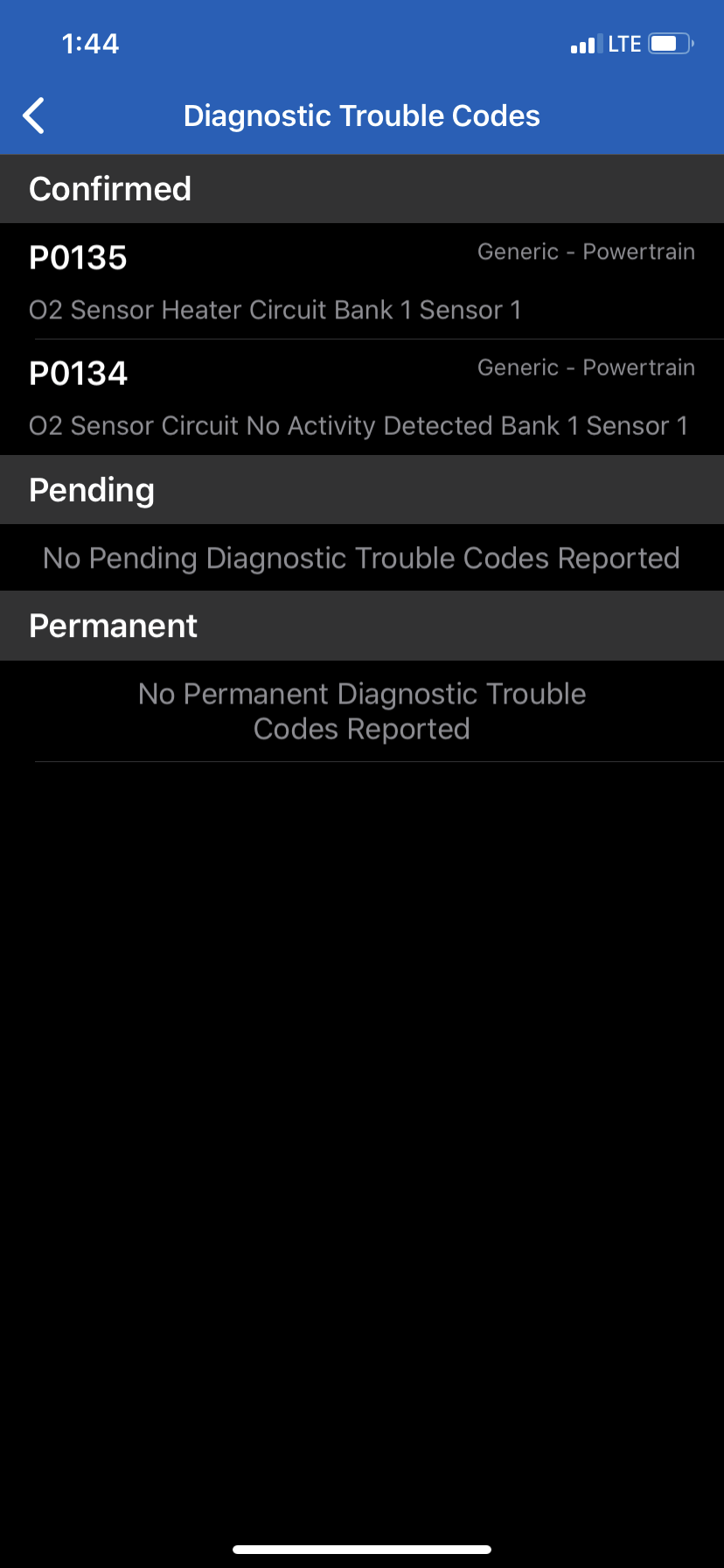

Default Poppin codes
These codes popped up
Was open loop then closed.
They are new walker O2 upstream sensors.
