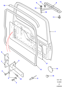

The part I think you're looking for is AFU1350, the monobolt 1/4 inch. It can be seen as #5 in the diagram below. The part is available at Rovers North for a few bucks. You should give them a call and confirm that it's the rivet you're looking for.
thanks Paul. Anybody looking at this, Paul is great. He is a parter and he has gotten me out of many jams with his parts. Always fair in his pricing and super fast. In fact the hinge I am putting on came from him. His info is in my tag line. Just now getting around to put it on.
