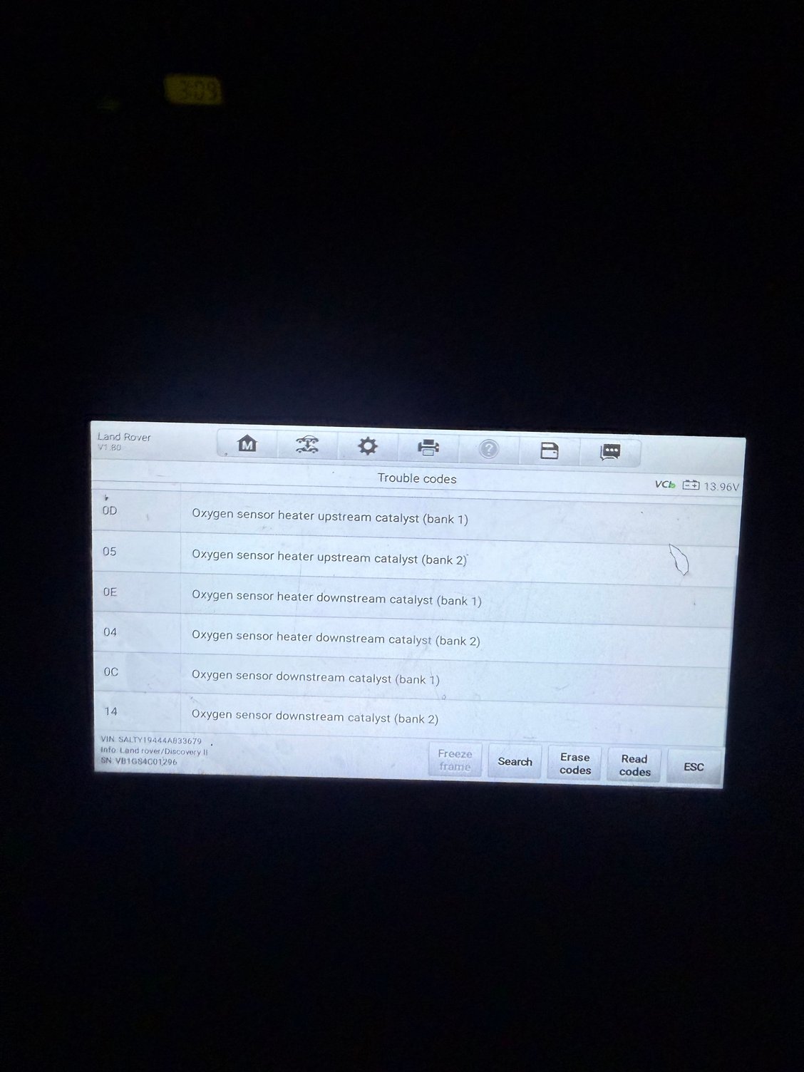

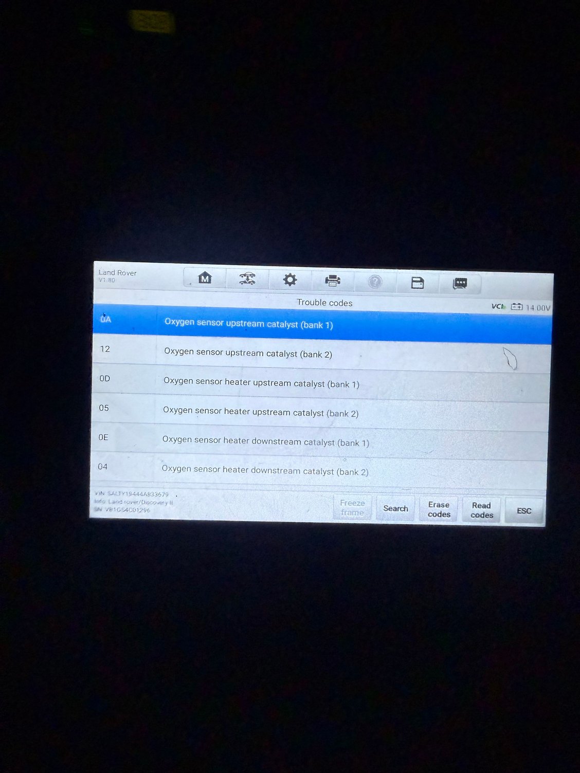

Help! Genuinely considering selling my 04 Disco over this misfire/rough idle. I rebuilt the engine ~800 miles ago and it’s been like this ever since.
Misfires, rough idle, and codes for all 4 O2 sensors, and all 4 O2 sensor heaters. O2 sensor values around 0.45V at idle.
Lots of condensation/water coming out of exhaust. Occasionally will get Cyl 8 misfire and stiff brake pedal.
Have tried:
- smoke test
- new Walker upstream O2 sensors
- removing/cleaning upstream O2 sensors
- swapping plugs, wires, injector (cyl 8 )
- plugging the brake booster line
- replaced intake manifold gasket
- resetting adaptions
- checked O2 sensors related fuses
Funny enough, it ran/idled perfectly for 1 day about 2 weeks ago. So I doubt it’s something mechanical

This sounds exactly to me like a bad ground issue. If the fuel injection harness does not have a good ground (in 2 places) it will misfire and run like garbage.
Saw this SAME thing on my friends D2 the day prior to a Moab trip last year. It was pressing because we would be off grid for 10 days so we had to fix it. What we found: The little ground strap that goes from the back of the engine to the firewall was broken in half. It would intermittently contact itself and be ok, but the engine moving around caused it to get an intermittent ground.
Also, check your main ground strap.
It would be a very easy fix. Check or replace that little ground strap on the back of the motor first. Then your main one. Heck, I’d just replace the ground cable (avail new from A-B they remade the cable their own house brand for pretty cheap).
If either is dodgy, you will get these exact symptoms. Weird codes, weird nonsensical intermittent misfires. O2 codes.
In my experience, you start to see fuel injection symptoms like this well before you see charging/alternator issues from the bad ground.
