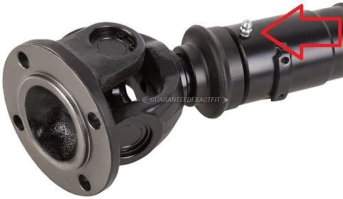

Yep that's all it is, and you want to keep it in place. Pic 1 is a "pretty" one. And if you just had to have a new one (TGV100000) then I guess across The Pond you might have to go > https://rimmerbros.com/Item--i-TVG100000

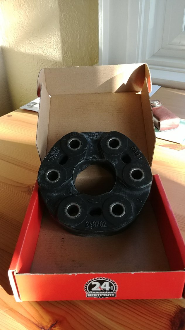

Yes, I noticed that about the RotoFlex and believe it or not I have a new one sitting in a box in the house. Too chilly in the driveway right now. Got that from over the pond!

I'm shocked to see a GKN Rotoflex in a BRITPART box, but good for you!!! That's the brand you want for sure.
Just a headsup, because working in the cold is zero fun spray the (6) nuts @ the rotoflex with some penetrating oil (PB Blaster, whatever) today.
Also to make your life easier grease the DRIVESHAFT SLIP YOKE. This way when you push the driveshaft forward to remove the rotoflex it will move no worries. Your frozen fingers will thank you!
