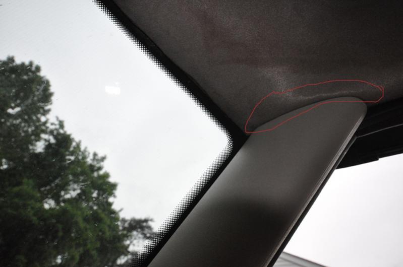

Image is attached of where the water is coming in. It's on the front passenger side. I'm thinking the windshield seal has been broken. Only other thought would be possibly the sunroof, but it's been dry around there. Is this something I can fix myself or should I take it somewhere? Thanks in advance.

Check your roof rails for a good seal, the gasket that seals them can fail and leak rain/carwash water into the truck.
Typically when the windshield leaks it goes onto the dash/floor.
Somebody correct me if I am wrong but the sunroof drains on the drivers side down the "A" pillar.
