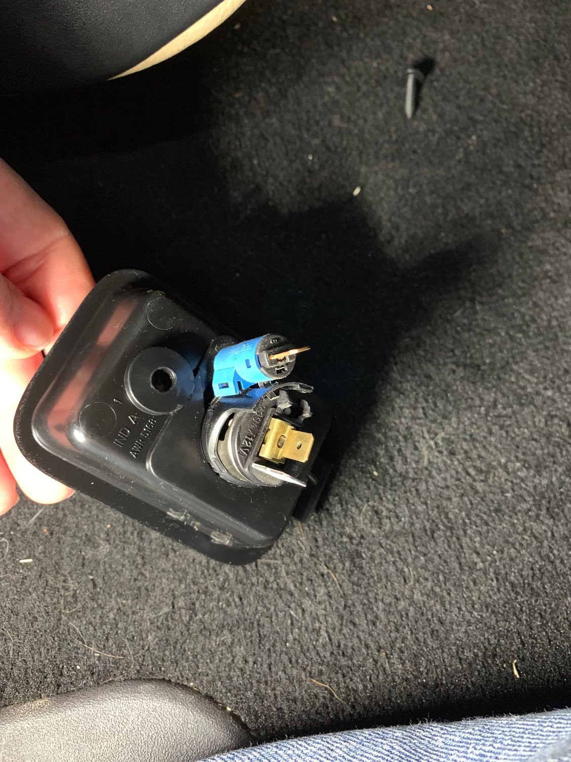

Anyone know where I can get a replacement light bulb for the rear power socket? I know...I know..but it bugs me that it’s burnt out....

Yep, it’s inside that blue assembly.

The spade/black portion is the bulb holder with a changeable bulb in it. Pull it out, take it to oreillys, they should have it in a blister pack from sylvania.
I might be wrong, but I don't see a listing from LR for the bulb separate from the complete assembly.
That accessory socket with the bulb is Part Number: AMR4039PMA can costs less than $15 from LR.
IMHO I would just remove the bulb and match it up at an auto parts store. Should be more than easy enough to do.
Or use some Google Fu with the part number and see what you can turn up re: the bulb.

When I pulled the blue assembly off, I didn’t check if the bulb was removable. It looked like it was built in as part of that assembly. I’ll double check. And thank you for that part number I’ll try some Google fu and see what I can see.

When you get the bulb out ( and you will ) I will bet a $1 what you're going to find is RTC3635.
That is the 1.2W front lighter bulb like in PRC9410.
Without opening one of these up, that's my best guess.
> https://www.roverparts.com/Parts/RTC3635

Yup, I got the blue cover off and sure enough, the bulb came out... It’s 12v 1.2w bulb. I got a 2 pack at AutoZone so now I have an extra for the 04 as well. The light works and all is well.
